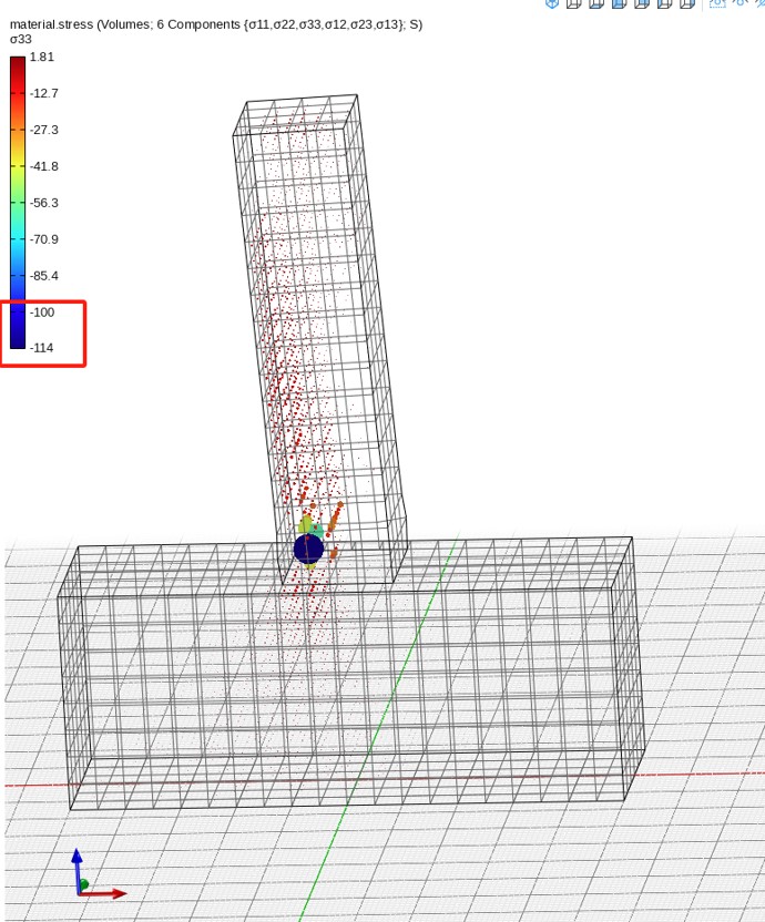

(1)Why is the stress value of the concrete in the post-processor much greater than the peak strength of the input concrete constitutive? For example, in my model,the peak strength of concrete constitutive is 22.8Mpa, while the maximum stress of concrete in the post-processor reaches 114Mpa. Is it all because of the triaxial compression effect?

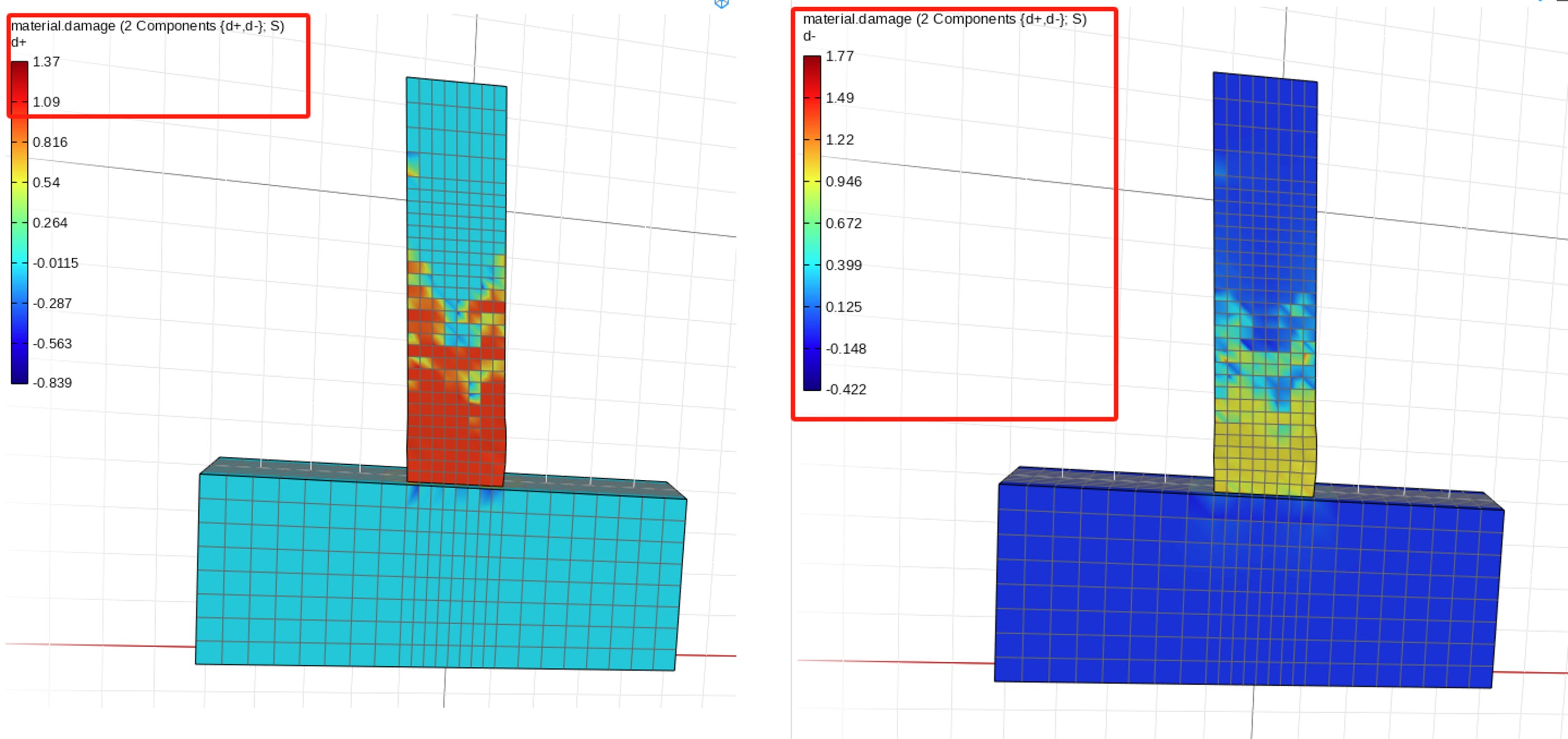

(3)Why is the material damage greater than 1 in the post-processor, and the damage is also negative?

(1)Why is the stress value of the concrete in the post-processor much greater than the peak strength of the input concrete constitutive? For example, in my model, the peak strength of concrete constitutive is 22.8Mpa, while the maximum stress of concrete in the post-processor reaches 114Mpa. Is it all because of the triaxial compression effect?
Yes, it's the triaxial compression effect, necessary to simulate the increased strength under lateral confinement
It's just because you are visualizing damage with a surface plot. In a surface plot you see the "extrapolation" of the values from the gauss points to the nodes. Since the gauss points are in the interior of the element, doing this linear extrapolation may give damage lower than 0 or higher than 1.
If you want to see the real value, use the gauss plot.
