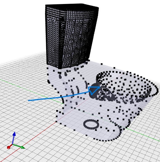

Thank you for your quick reply! I did, I imported the geometry. I did your recomendation, but I think the mesh is still wrong.
Could you please guide me?
Screenshot 2024-02-01 162657.png (104.25 KiB) Viewed 4743 times
Salvador Ramos
Re: meshing irregular solids
Post by kesavapraba » Sat Feb 03, 2024 1:29 pm
Ok, can you please send me the stp file of the geometry? I will try to look at it.

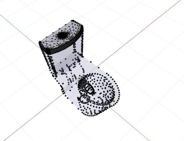

Post by kesavapraba » Fri Feb 16, 2024 6:58 am
Hi, Sorry I tried my best to figure out the issues in your geometry. I could achieve meshing the top portion only. The geometry of the model is complex, particularly in the lower portion of the model, there can be some short edges that creates the issue. You can recreate the lower portion, add every small geometry in a step-by-step manner and simultaneously check for successful meshing. In this way you can come to know where the issue is.
Post by STKO Team » Mon Feb 19, 2024 9:07 am
Also, the main issue with your geometry is that it comes from a STL or Obj (it's clear that it is tringulated). It would be better if you work on a clean geometry
