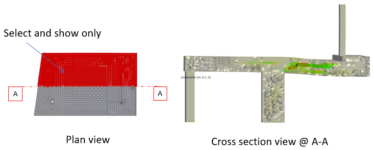

Re: RE: Visualizing soil stresses in soil block
1] Yes, you can visualize the cross section by selecting the soil portion that you are interested in and showing only that portion. Please refer to the attached figure here.
2] It is not clear for me to understand the context of your query, however, you can explore "Vector Plot" if it helps.

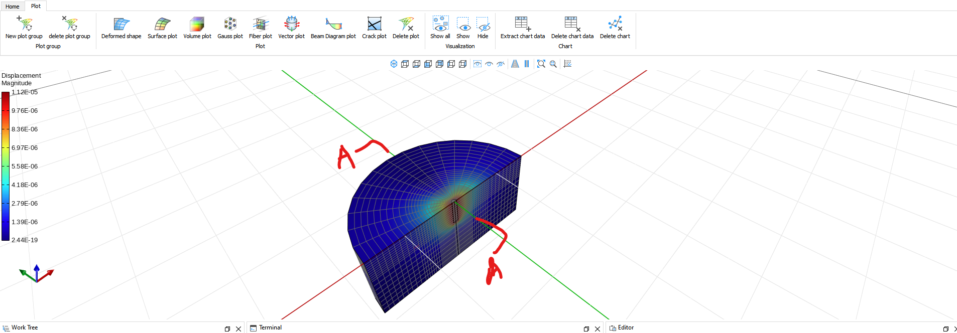

1) I am not too sure what you mean by selecting the soil portion and showing only that portion. However, this is what I want to view, a cut section of the soil body (section A-A, as shown in the image attached). 2) I am interested to view the quantities of ground water flow in a soil body subjected to a loading, i.e q (m/s or m3/s) of the water caused by a difference in water pressure gradients. I have checked the vector plot, however, there is no such result available. Could there be another way to view the flow of water in the soil body during the loading analysis.
Hi, Following are my suggestions:
1] You can select the entire front side of the cut (A-A in your attached figure) and hide the view. This will show the portion of the soil you are interested in.
2] Visualizing the flow of water in the soil body is not possible, however you can visualize the pore water pressure.
