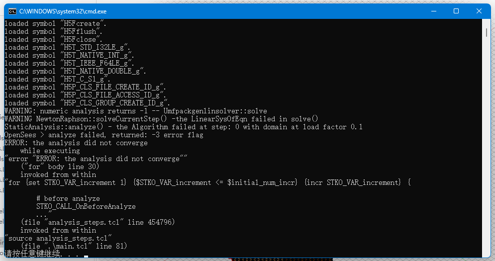

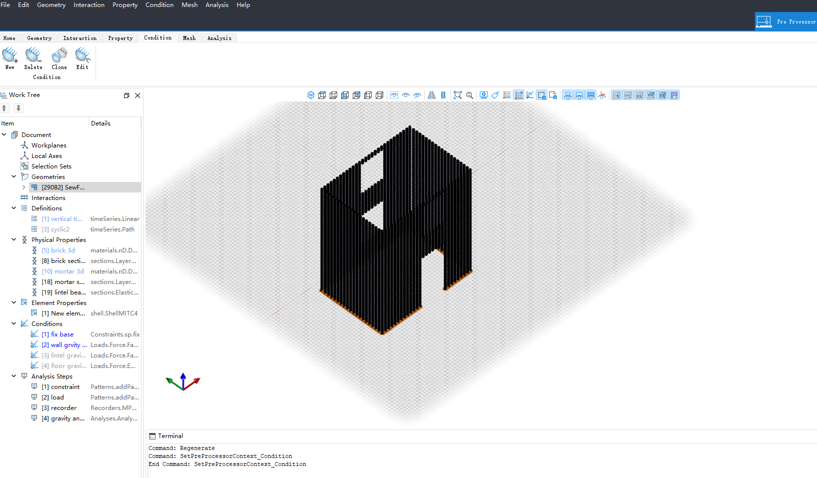

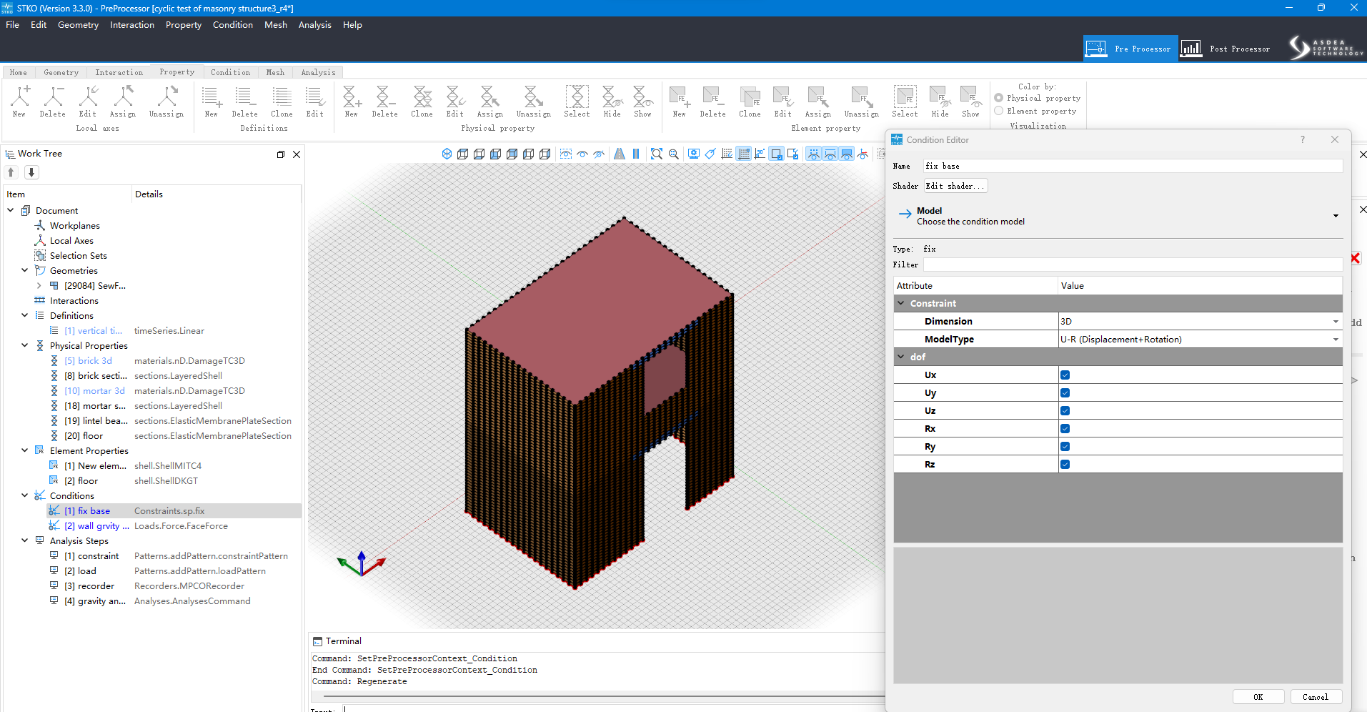

Dear STKO team, I encountered a strange problem when trying to perform a three-dimensional microscopic modeling of masonry structure. However, when I conducted a gravity analysis on one wall alone, the analysis proceeded normally and there were no issues. However, when I merged several walls to create a masonry house, I encountered the error in the following image. I really don't understand why. The boundary conditions are set as shown in the figure below, and I don't think there is any problem. This question has been bothering me for several days, and I would greatly appreciate it if you could answer it for me.

If you see the line "Warning: numeric analysis returns -1" it means that your model is singular.
From what I can see from the image, your slab is not attached to the walls

Thanks for your reply, but it seems that you misunderstood what I want to express. In fact, I have merged the slab and wall, but I accidentally set the shader color of the slab to red, which caused you to misunderstand. Even if I removed the slab, only four walls remained, merged them, fixed the bottom, and ran the analysis, the program still reported this error. This really troubles me. I have attached my SCD file. Could you please help me check it.

At present, what I can confirm is that all the walls have been merged into a masonry structure. I fixed the bottom of this structure and conducted gravity analysis, but still encountered the error of singularity in the stiffness matrix. Because of this, I really don't understand why. I sincerely desire for your reply.
