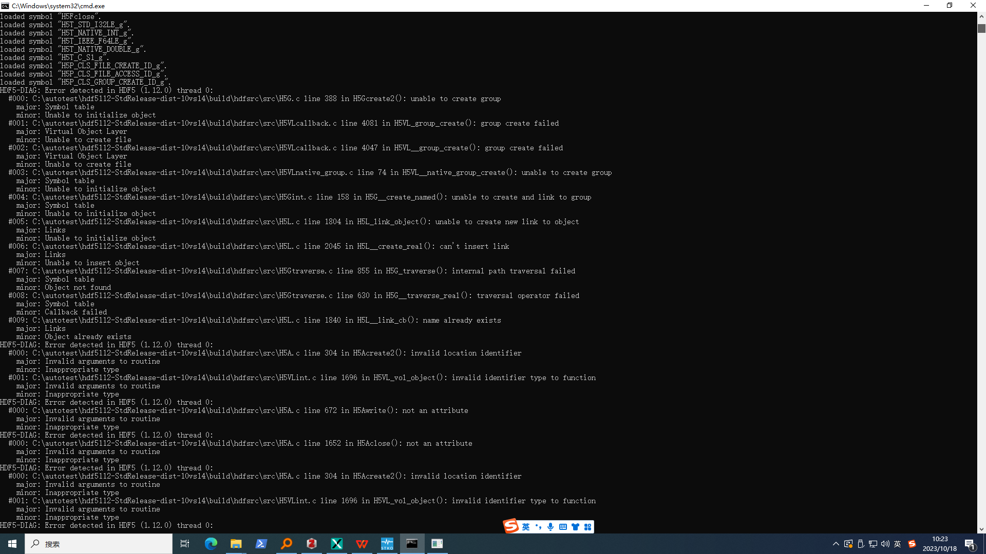

Dear STKO team, there is an error in the following pictures when I try to simulate the cyclic test of a masonry building. Can you tell me how to deal with it?
Re: Error detected in HDF5 (1. 12. 0) thread 0
Post by STKO Team » Wed Oct 18, 2023 8:18 am
Can you share your SCD file? Or check if you requested the same elemental result multiple times (it looks like there is a name conflict).
Post by STKO Team » Fri Oct 27, 2023 10:03 am
Did you check this?
In fact you have material.damage defined 2 times. once in the built-in checkbox, and once in the custom list of results
