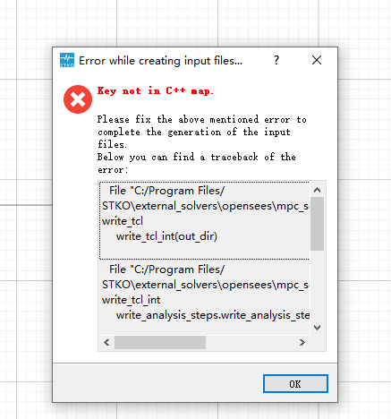

Dear stko team, I have done the meshing, why do I still get this error? (Keynot in c++ map)。 Please check it out for me, it's important to me, thank you! Have a good life.

If you look at the whole error stack trace, you will see this errors comes from the Monitor.
It's because you did not provide any selection set.

Thanks for your help, I fixed this issue but it still doesn't work.

Post by STKO Team » Mon Sep 25, 2023 9:46 am
Actually, it worked. It's simply another error now
see this
viewtopic.php?f=33&t=2680
