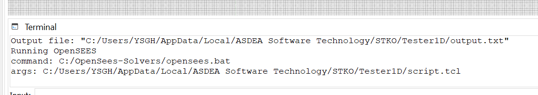

Dear Team,
I am facing an issue. Whenever I add some physical property in the model. After clicking Ok. The software gets closed automatically.
Kindly help me in this regard
Screenshot 2023-09-15 120404.png (32.93 KiB) Viewed 4929 times
Screenshot 2023-09-14 204730.png (16.87 KiB) Viewed 4950 times

Post by STKO Team » Mon Sep 18, 2023 9:27 am
Can you share the file that is giving the issue?
We found something similar when one of the geometries is corrupted. This is solved in the next STKO version 4.0.0.
But now (until we release it by mid October) I have to look into your file to find the corrupted geometry

Re: Stko gets closed automatically
Post by STKO Team » Wed Sep 20, 2023 3:33 pm
I deleted 2 masses and 2 eleLoad conditions that were not assigned and seems to work. Let me know if it works on your side
