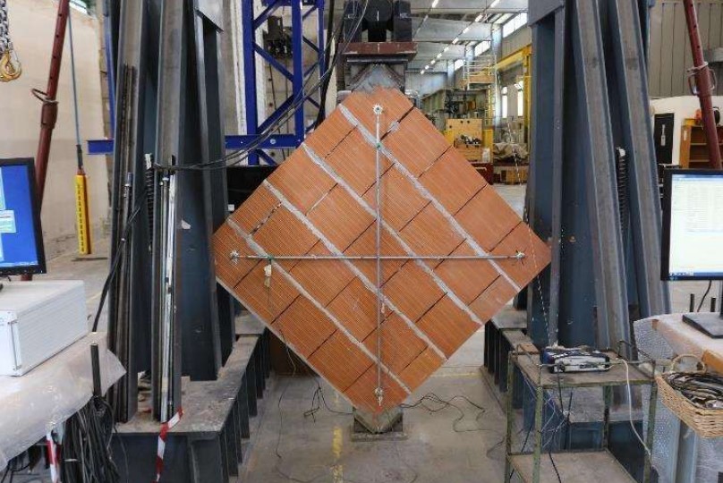

Dear STKO Team!
I'm approacing to masonry micro-modeling and I have to reproduce an experimental diagonal test on a simple panel. I red about different strategies proposed by Petracca and others authors in the article: "Micro-scale continuous and discrete numerical models for nonlinear analysis of masonry shear walls". As you can see i have only horizontal mortar joints instead in the vertical ones there's no mortar; so which physical and element properties would you suggest to simulate interfaces between bricks? Currently my model is based on the 2D-C solution.
Thanks for the support!
DIAGONAL_TEST_MASONRY.zip
(209.83 KiB) Downloaded 255 times

You can keep working with the 2D-C model.
But in the brick-to-brick interface you can use a different material with a very small (almost 0) tensile strength

Great! But shall i carry on with the DamageTC3D? Maybe assigning brick's parameters in compression and quite small values in tension or shall I go for an other material?
Thanks again!
Re: masonry micro-modeling
Post by STKO Team » Wed Aug 09, 2023 8:50 am
you can go on with DamageTC3D (or also ASDConcrete3D).
with:
  1. small tensile strength/fracture energy (but not exactly zero)
  2. high compressive strength/fracture energy (so that it behaves like hard contact in compression)
  3. pdft and pdfc = 0, so that you don't have plastic deformation
This should result in a bilinear behavior (elastic in compression - zero in tension)
