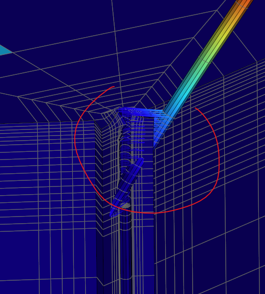

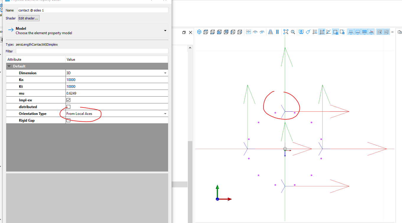

You are using the "From Local Axes" option in contact, but you didn't assign any local axes to the interaction. Therefore, they will have their default one, with Normal = global Z (0,0,1):
In this way, the contact is not working fine, and you experience penetration of pile into soil:

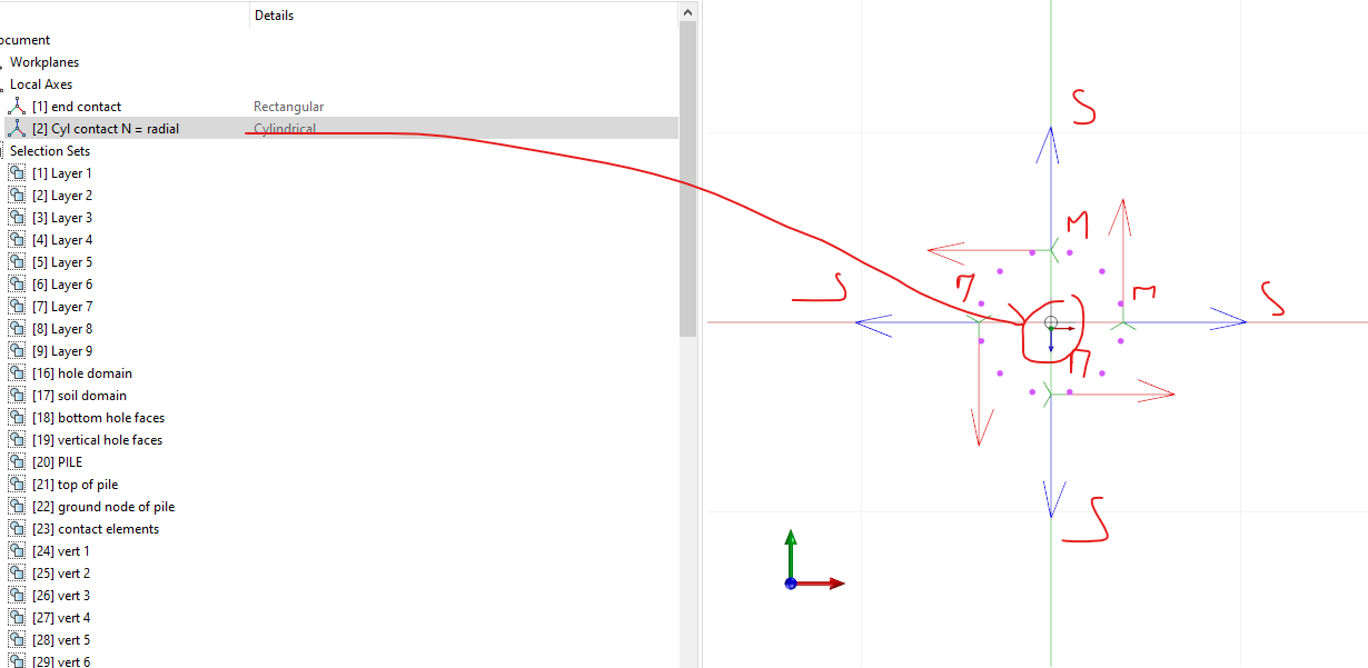

Instead you need a Cylindrical local axes, with center at the center of the pile, so that the Normal vector will be radial (from master beam to slave soil):
In this way it works fine:
