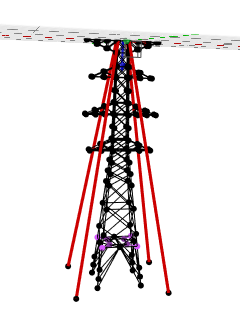

I need your help,how to built a only tension bar or lasso.WHAT can I do?
I attached the picture where is the only tension bar.

Make a truss with an elastic bilinear material like this (instead of 1000 put your actual Young's modulus)
