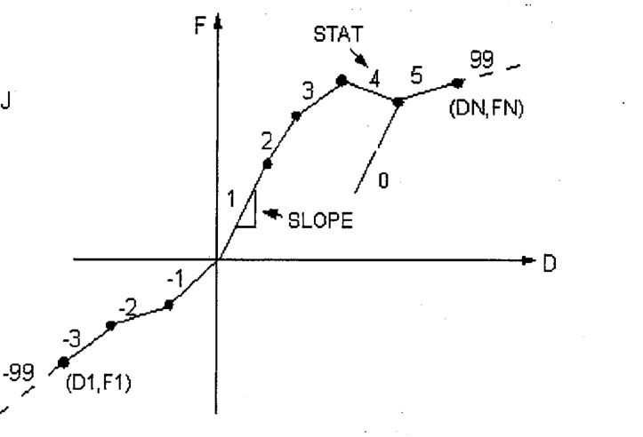

Is there any material in stko that can simulate nonlinear spring?(Using zerolength element)
Its spring stiffness can not be a constant, but a customized curve

- 屏幕截图 2023-03-14 172300.png (29.45 KiB) Viewed 4137 times
Re: Is there any material in stko that can simulate nonlinear spring?
There are many. Try the Pinching4
