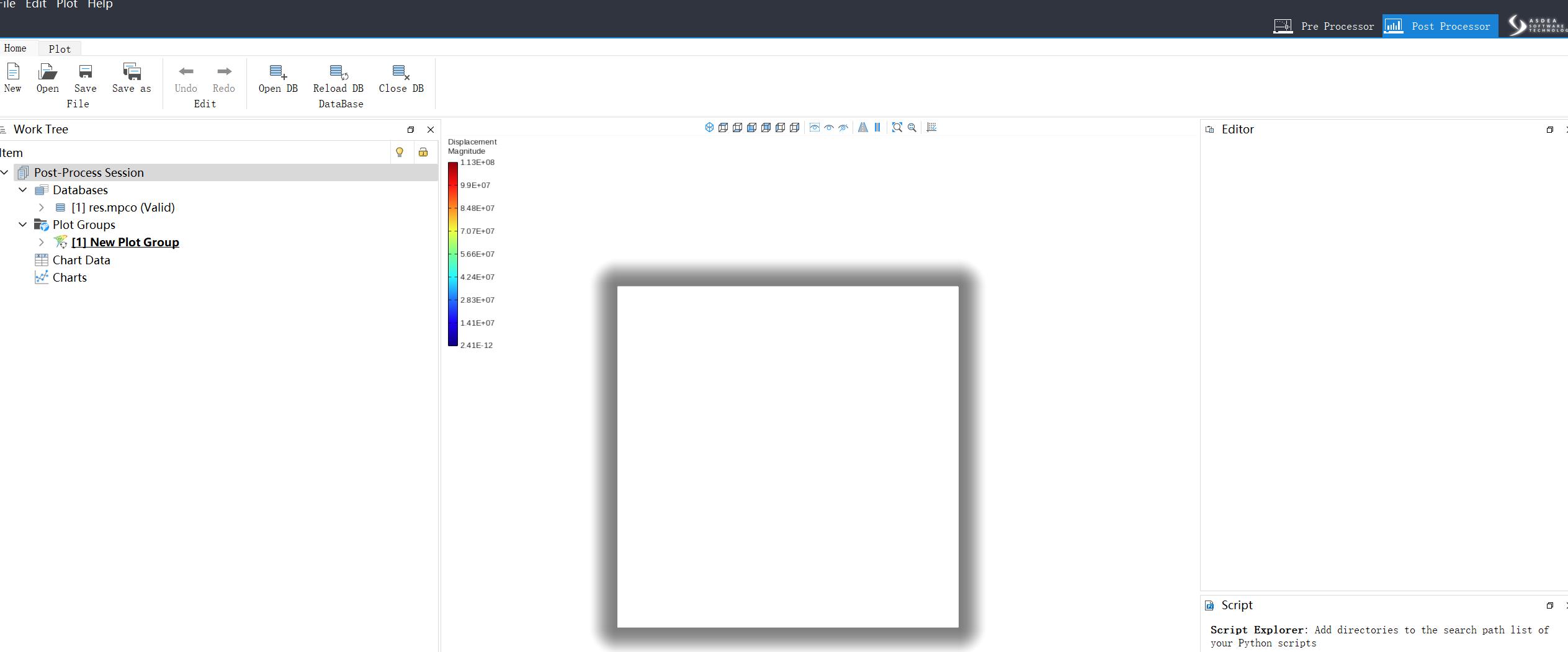

Re: The non-convergence of gravity analysis in two-dimensional tunnel modelis
Thank you stko I have modified my model,
but after the gravity analysis (elastic phase), I open the post-processing module and cannot display my post-processing. What is the reason?
(The post-processing of other models can be displayed normally when I open them)
page 1 is my model post-processing results
Here is my modified model
- zou (2).zip
- (191.09 KiB) Downloaded 154 times
- 4.png (87.83 KiB) Viewed 2732 times

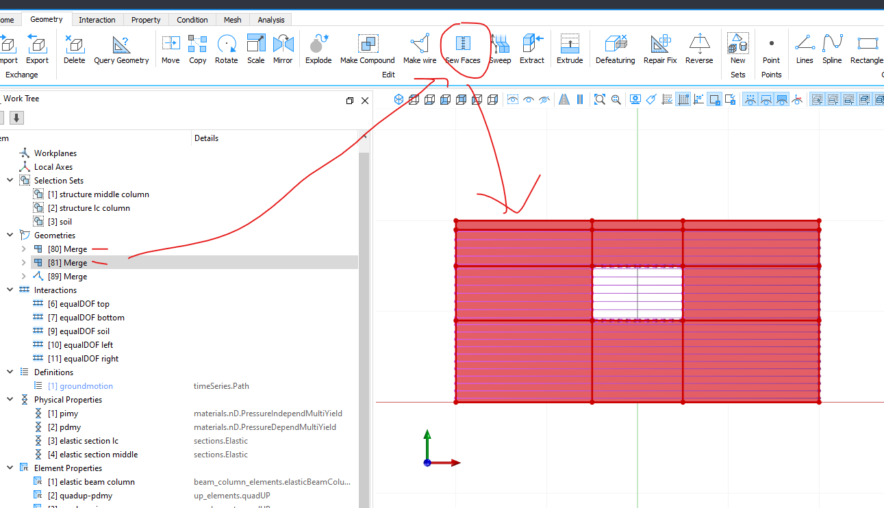

the top layer of soil is detached from the other one. It is falling down.
Select the 2 soil layer, merge them using the SewFaces command, and re-mesh. The analysis should run after that
