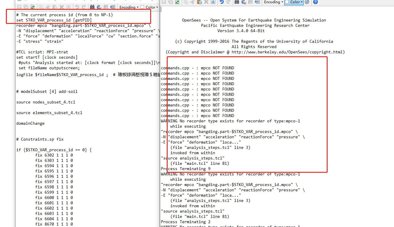

When I used linux supercomputer system to calculate, the command model ran normally when I deleted mpco record. When I joined mpco, I encountered a new problem, I spent a week, but finally failed. Could you give me some advice?

The STKO_VAR_process_id is automatically defined by STKO in the main.tcl file.
If you just copy-pasted that piece of code inside a file which don't declare that variable you have that error.
Just put this lines at the very beginning of your tcl file:
# The current process id (from 0 to NP-1)
set STKO_VAR_process_id [getPID]

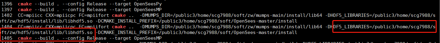

When compiling the program code, I used Cmake, is there any other reason? I asked my colleague to follow the tutorial to compile, but it's the same problem, when I delete the mpco record, the program runs normally, but when I join, I can't record the result normally. Can you give me some advice?

If HDF5 1.12.0 is not installed in a directory that can be found automatically by CMake, you can help CMake find it by specifying the HDF5_ROOT variable as the root of your HDF5 installation.

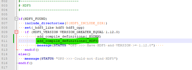

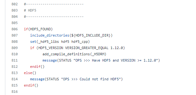

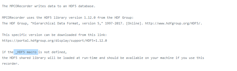

As for HDF5, we still have problems after installing HDF5, cmake found HDF5, we studied the source code. In the source code, it defined HDF5 as if def _HDF5, and then executed mpco, but we checked the hdf5 compilation file under linux. There is no definition of marco _HDF5 in it. Then we check the official website file of hdf5 and find that it exists in the shared library of hdf5.lib in windows version. Now the main problem is that we can't find the definition of _HDF5. We tried 1.12.0 and the latest 1.14.0 hdf5, but we couldn't find the definition.Forum You provided the definition of HDF5 for windows. Can you demonstrate the definition of HDF5 for linux?,For example in Linux

The preprocessor macro _HDF5 is not in HDF5 itself, it is a macro required by OpenSees, so you should defined it in Cmakelist.As for HDF5, we still have problems after installing HDF5, cmake found HDF5, we studied the source code. In the source code, it defined HDF5 as if def _HDF5, and then executed mpco, but we checked the hdf5 compilation file under linux. There is no definition of marco _HDF5 in it
You are right, the CMakeList.txt contains an error.
It only defined the _H5DRM macro (used for the DRM object).
It should also define the _HDF5 macro
Try this and let us know.
