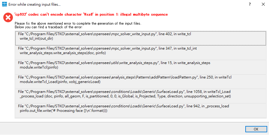

I just started to study STKO with the e-Learning courses.
An error pops out when I run analysis with the ex4 in W3:
By removing the analysis steps, I believe the problem is in the 'load',
but I'm not sure what is the reason and how should I edit it.
Sincerely,
Uki
Re: Problem in the ex4 of e-Learning
Posted: Thu Nov 17, 2022 11:16 am
The error is saying that you have a special character in your output directory.
Please don't use special characters in the files directories.

Thank you for the quick reply.
After changed encoding from Shift-JIS to utf-8 it works to me.
The analysis can run now.
