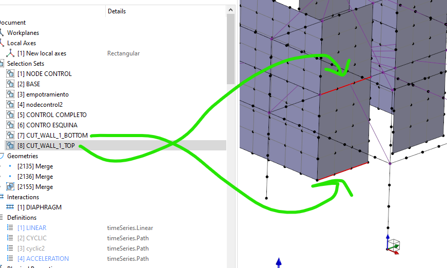

In the meantime, I prepared a "relatively" simple TCL script that allows you to do the "Section Cut" for integrating nodal forces and moments along a Linear Cut.
Note: For simplicity, it will work only in 3D models, only for 2-node beams and 4-node shells (like in your file).
Note: It works only if you use 1 partition (instead the integrated tool in version 3.2.0 will work for every element, and for any number of partitions)
Here's your modified file:
08-MODELO EMPOTRADO 2 PISOS.zip
(446.05 KiB) Downloaded 218 times
You can create selections sets for all the Edges where you want to compute Section Cuts:
For each selection set, you can create "Regions", in order to have a TCL list of nodes for each Section Cut.
After all regions, there is a script for the Section Cuts.
In the first lines, you have the User-Parameters (i.e. settings that you can change). Have a look at the descriptions, but it should be pretty easy to understand.
Pay attention to the "cut_sides". it should be +1 if the elements are on the +X direction of the cut, or -1 otherwise:
Signs and elements.png (47.89 KiB) Viewed 5585 times

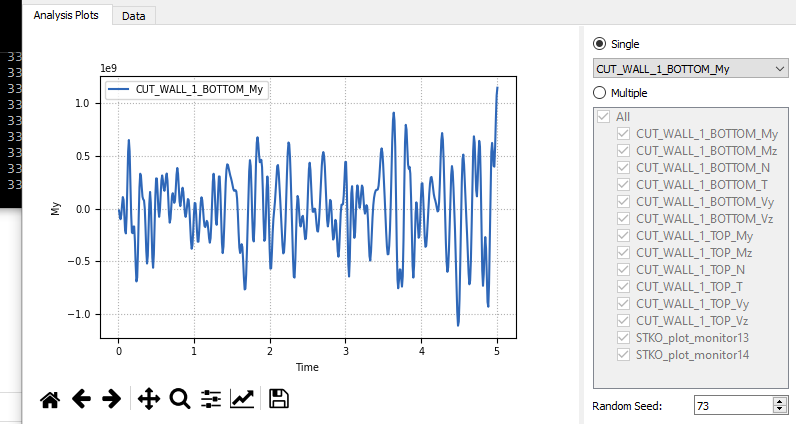

This script will generate 6 files (for the 6 components N, Vy, Vz, My, Mz, T) for each section cut in a folder called "CutFiles".
These files have the same format of the Monitor Plots, so that if you have a monitor, you will be able to see them in real-time:
