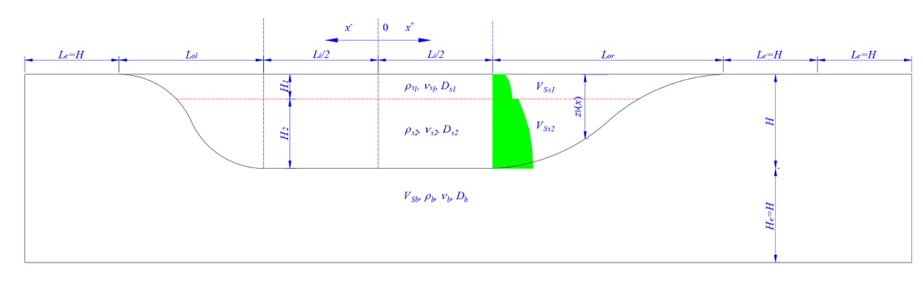

I'm trying to model a soil domain which is formed by a soil deposit (of 2 layer) on top of a bedrock layer, I attach the draw below.
1. I built the geometry of the 2D model with Python API but i have some problems creating the second layer in my soil deposit. Below i've attached the Python script.
2. I also need to generate some codes (using Python API) to implement the physical properties by specifying various geotechincal parameters to be assigned, how can i do?
For example I have to assign a velocity trend that varies with depth within each layer, is it possible?
