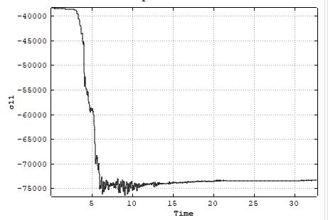

However, regarding horizontal stress, are there any effects of relative or absolute values? or just extract the earth pressure? as in Fig1, horizontal stress increased significantly and kept unchanged even I used much small input motion.

However, regarding the horizontal pressure of soil as in Fig 1 above, it increased significantly during EQ and kept unchanged at the end of EQ (residual value) for both uniform and multi-support excitations. I think its not correct
Can you suggest any solution for it? It can be due to boundary condition?

This is normal according to your model.However, regarding the horizontal pressure of soil as in Fig 1 above, it increased significantly during EQ and kept unchanged at the end of EQ (residual value) for both uniform and multi-support excitations. I think its not correct
You fixed the Ux displacement (with fixes during the gravity, and with EDOF during dynamic). It means your soil cannot expand in the X direction.
So you first see a Sigma11 coming from the poisson effect (in the elastic regime).
Then, while your model goes into nonlinear regime during dynamic analsyis, you see the effect of dilation (plastic increase of volume due to plastic shear strain). But since the overall X displacement is fixed, your soil cannot "dilate" and so it will show increasing confining stress

But I already removed Ux constraint before EQ shaking. Now, I changed boundary condition in my model to fix Ux, Uy at base and EqualDOF at 2 sides during both gravity and dynamic. However, the horizontal stress have the same problem as before. you can see it in attached file.You fixed the Ux displacement (with fixes during the gravity, and with EDOF during dynamic). It means your soil cannot expand in the X direction.

What I mean is that in the second stage, even if you remove the Ux fix at the vertical sides, you added an EqualDOF.
Now, imposing Ux_Left = Ux_right means that there cannot be an expansion in the X direction. Since the model has dilatancy, during plastic loading the model would like to expand for both 1) the Poisson effect, and 2) dilatancy induced by plastic shearing.
But since you are imposing an equalDOF in the X direction, the overall (mean) expansion in the X direction must be zero. Therefore, as a reaction to this constraint, you see increasing stress in the X direction.

It makes sense, but many researchers also used periodic boundary condition to simulate the boundary of centrifuge test.
Do you have any suggestion to simulate the boundary condition of centrifuge test? I have tried AutoSTKOAbsorbing BC, but cannot get the similar acc at free-field surface that I can get exactly the same if I use periodic boundary.

I think that the periodic conditions are fine for a centrifuge test. Try to google and search for similar issues. For example: "boundary effects in centrifuge tests"
