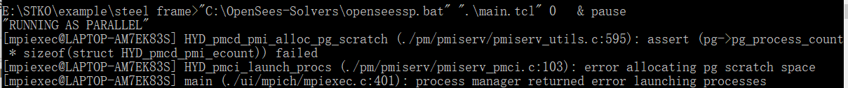

I creat a steel frame model and try to run analysis,but after "Run Analysis" the error show below appear in dos.
ERROR OF STKO.png (27.32 KiB) Viewed 4625 times

It's because you are using OpenSeesMP (for parallel analysis) but you forgot to partition your mesh
Thank you so much.
