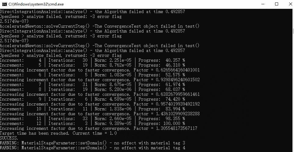

However, due to an oversight on my part, the upper clay (L1 ) and the lower sand (L2 ) in the Model1 version are using the same BrickUP Element, which results in a fairly large permeability coefficient for L1 throughout the analysis (up to 100!).
After noticing this error, I modified it in Model2 by dividing the BrickUPelement into two, L1 and L2. In the L1 Element, I set the permeability coefficient to be quite small (1e-9), and it all sounds perfect, right? However, when running the analysis, after running Excavation Analysis, the pop-up "WARNING: MaterialStageParameter::setDomain() - no effect with material tag 3
WARNING: MaterialStageParameter::setDomain() - no effect with material tag 4", I don't understand why this warning happens and the analysis seems to stop after this (although the background shows that OpenSeesMP is still trying to calculate it).
The only changes I made were:
1. copied a BrickUP Element, renamed it to Soil L1 Element and changed the permeability factor to 1e-9
2. selected the InitialStateAnalysisWrapperL1 (PIMY) in the Physical Element and assigned the Soil L1 Element to it
Can you guys help me to check what is going on? Thanks a lot!

Re: Running problem of sfsi model in webinar25
Try this:
it's running also in the last dynamic analysis.
But it has serious convergence issues. I think mainly due to the plasticity in soil.
In fact, if you look at the 3rd stage (just after you activate plastic behavior, before adding the structure) you will see high accelerations in the areas near the holes.
Probably because your pseudo-static analyses have a too short duration (1 second). Make the duration larger to avoid inertia effects in those pseudo-static stages.
Anyway, what I changed was the maxDim in the KrylovNewton set to 2*maxiter, so that you compute the tangent matrix only once per step
