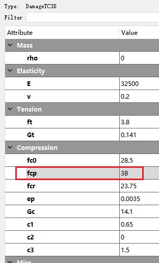

I want to know the compressive peak strength (fcp) of concrete in Damage TC3D is the value of compressive strength by concrete cubes (150 × 150 × 300 mm3 ) or prisms (150 × 150 × 300 mm3 ) or cylinder(D=150 mm, H= 300 mm)?

Cylindrical compressive strength.
