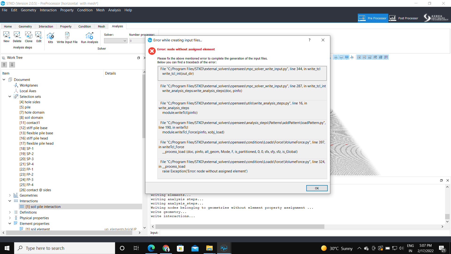

hello team,
This is the error what i got while running analysis. Can you please help me out
Screenshot (14).png (193.72 KiB) Viewed 1072 times
Re: analysis failed
Post by STKO Team » Thu Feb 17, 2022 3:15 pm
You applied a VolumeForce (you can see it from the bottom of the trace-back message) on a geometry without an Element Property assigned
