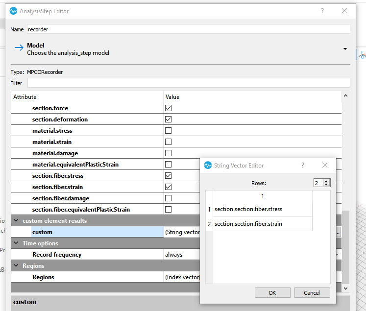

The post processor does not show the fiber color map results. I tried to rebuild the model many times but can't get any improvement.
I attached the file, any help would be much appreciated.

Recently the OpenSees' developers changed the way the section aggregator handles the results (unfortunately).
Before you could as for
section.fiber.stress.
Now, since the fiber section is a section inside another section (aggregator), they changed it to:
section.section.fiber.stress
To solve this you need to:
- Download and install the new OpenSees-solvers (version 3.4.0) from:
- Here is the file with the small change in the recorder (you need to do this everytime you have a section aggregator, but not when you use directly the fiber section)
here is what I changed in the recorder:
- section_section.png (43.52 KiB) Viewed 2028 times

This was very helpful! Thank you.
