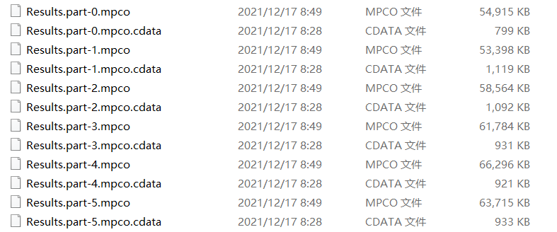

What is the difference between these 5 files? Which file should I import?

They are simply 5 parts of the same output because you did a parallel analysis with 5 processors.
You can simply load one of them, and STKO will automatically open all of them as if they were a single file
