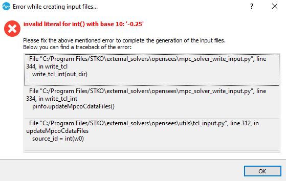

Dear Team,
I have recently installed the new version of STKO.
This error appears when I try to run the analysis of models including the beamShearHingelement/properties. It did not appear before installing this new version. It even appears when I try to run the files that you uploaded for the Week20 webminar. So I bet it is a bug.
Regards!

Yes, to make it work with version 2.0.5 we needed to change 2 python files (that will be available in the next version).
Read the instruction.txt file inside the Week20 folder
