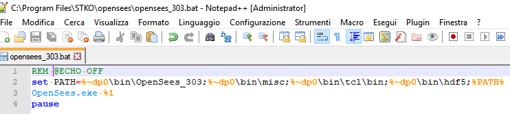

  • Edit "C:\Program Files\STKO\opensees\opensees_303.bat" with a text editor (I use Notepad++) with administrator right (Notepad++ > Right Click > Run as Administrator) and comment the first line
  • run the batch file and it should print the PATH variable and then start the OpenSees interpreter. Reply to this post

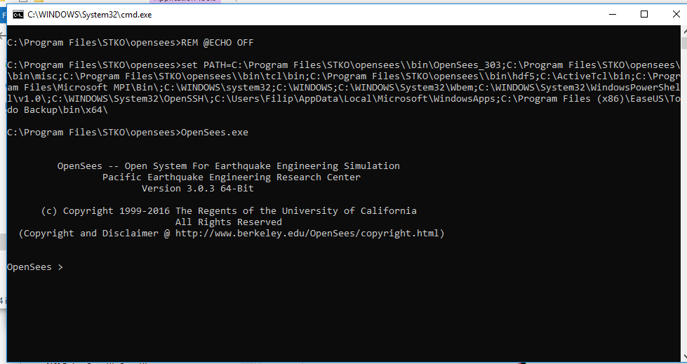

  • fig. 1 shows what happens when i run the batch file without any intervention
  • fig. 2 shows the intervention as you suggested
  • fig. 3 shows the response after the intervention

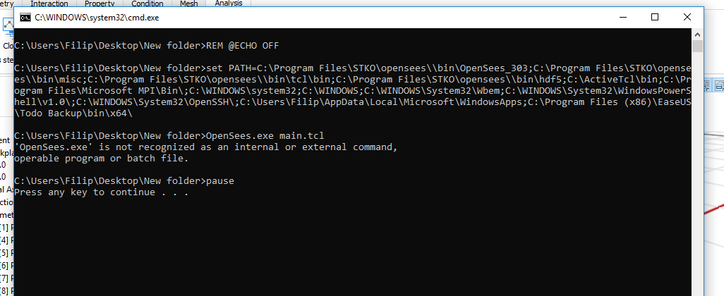

  • fig. 4 shows the response of STKO when i run it with intervention in batch file

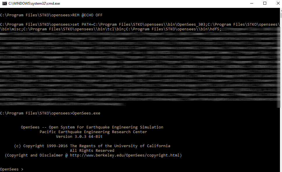

  • fig. 5 shows the original problem, no interventions and not copied opensees.exe in the file directory

This is even stranger than what I expected! From fig.1 and fig.3 I see that if you run the batch file manually inside "C:\Program Files\STKO\opensees" it can find OpenSees.exe, in fact you see the OpenSees interpreter cmd line.
But (fig.4 fig.5) when you run it from STKO, it runs the batch file from the directory where you have the TCL files (in your case "C:\Users\Filip\Desktop\New folder". And in that case it cannot find OpenSees.exe, even if the PATH variable is correctly set as shown in fig.5!

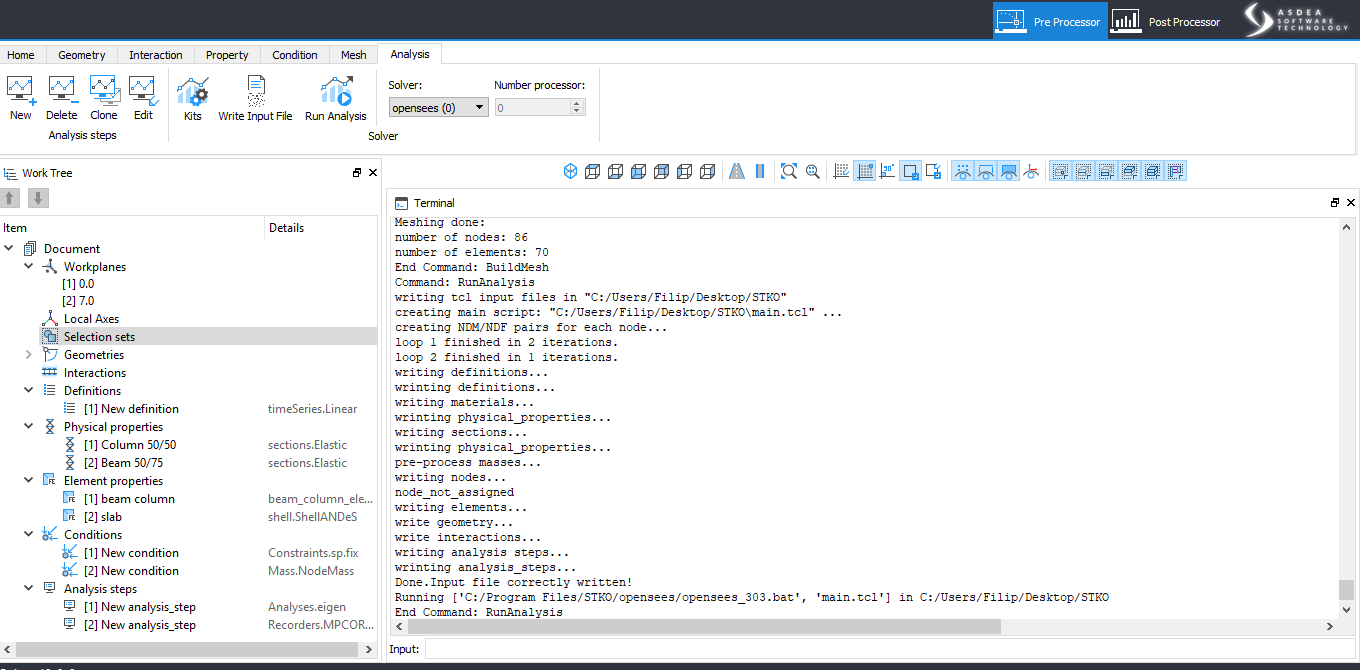

Unfortunately i still can not get the output file. I did copied OpenSees in the directory that you suggested (you were right, the bin\opensees directory was empty) and the only improvement is that STKO runs the main.tcl without the need of the batch and opensees to be in the folder with main.tcl file. The version that i have is 3.0.3 64-bit Windows. PLease find attached the screenshots with text part of the analyses.
Is it in the end maybe a mistake that i might be doing in the preprocessing part ?!

Everything is ok, it looks like OpenSees started and managed to load the HDF5 library correctly. I don't see any error message, so you should see the results (*.mpco file). If this is not the case, send me your pre processing file *.scd (attach it to a reply) and I will have a look, probably the analysis steps are not set up correctly.
EDITED:
I've just figured out the reason why you don't see the output *mpco file, by looking at the screenshot (fig. 1). You have 2 analysis steps:
  • eigen
  • MPCORecorder
The probelm is that the recorder will be written in the TCL after the eigen command, and so it will not record anything, since in OpenSees a recorder can only record results computed after it has been created. So just move the recorder command up in the WorkTree using the up/down arrows in the header of the WorkTree (left click on the MPCORecorder item and click on the UP arrow in the top-left corner of the WorkTree).
This is enough in 99% of the case, i.e. when you have other analyses after the eigen command. However in this case you only have the eigen command! Unfortunately in OpenSees the "eigen" command does not automatically call the "record" command, which instead is called by "analyze". So whenever you want to compute only the eigen analysis, just create a 3rd analysis step of type "CustomCommand" where you can insert your own TCL code. In this case we just need to put the "record" command

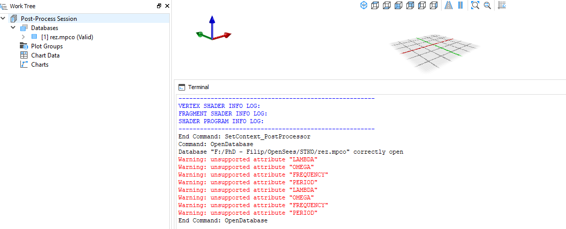

Finally the problem is solved. I get the results file and the analysis goes fine. Unfortunately when i try to load the database in post processing part i get some error again but in order not to bother you additionally i will try to solve that issue and if i fail i will let you know :)
