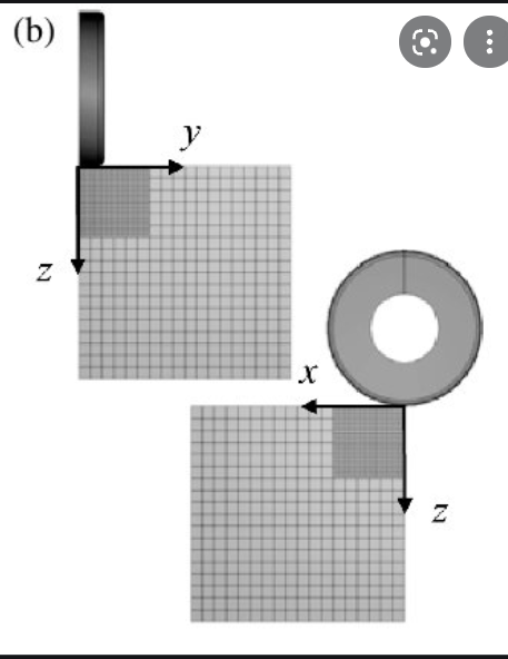

The model is a flexible tire laying on granular soil. I attache a picture of the model.
https://www.researchgate.net/publicatio ... gures?lo=1

Let's say that achieving that in OpenSees is not super easy now.
1) You need a contact detection algorithm, because the tyre travels in time, and the contact element should be updated at every step. OpenSees does not have such a tool now. We are working on it, but I cannot tell you when it will be ready.
2) Probably you need large deformation (finite strain) which is not available in opensees for solid elements.
