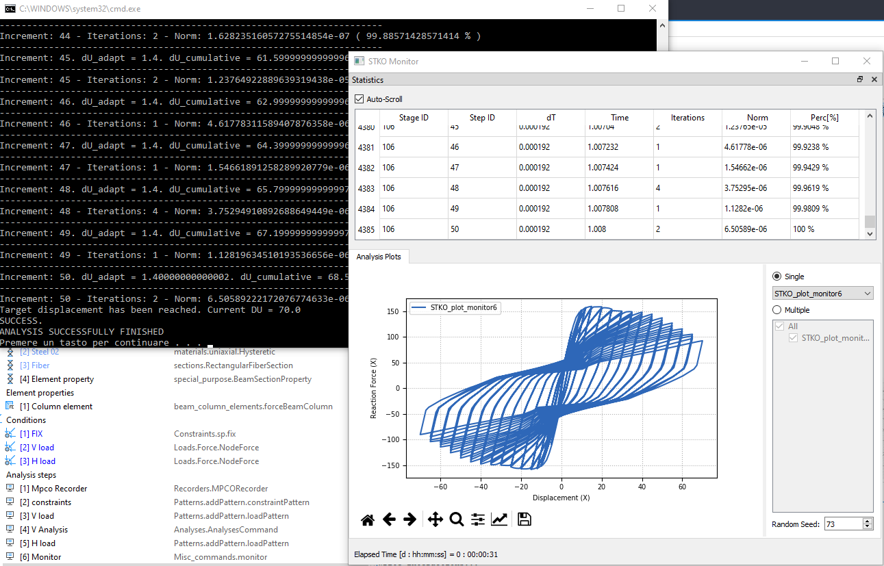

I had modelled some columns last year when there was no option of cyclic displacement in analysis command and they were running fine. Now I am running those models again, there is a convergence issue due to load Pattern I guess.

I just ran your model and it finished smoothly without any issue as you can see (I'm using OpenSees 3.3.0):
Immagine 2021-09-13 101411.png (176.51 KiB) Viewed 1650 times

The Problem got resolved. I was not using the latest version of OpenSees.
