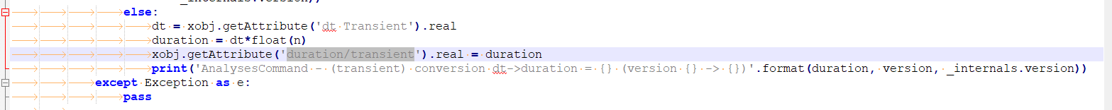

Here is an example of the information you were looking for, which was found in the AnalysesCommand.py file:

no bug there, just some notation that it's hard to find.
For a transient analysis the attribute duration is called "duration/transient":
So you need to substitute this in line 103 in your code:
doc.getAnalysisStep(13).XObject.getAttribute('duration/transient').real = float(N[k]*0.01)C:\Program Files\STKO\external_solvers\opensees
and explore how each X-Object is created.
Let us know if you need anything else.
