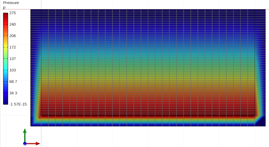

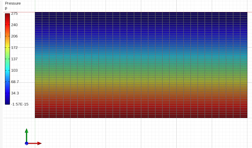

As in attached figure 1,
the depth of my model is 30m, water level at 2m from the ground surface.
The pore pressures of all element close to the boundary are 0.
The problem is The pore presure should be increase with depth, but it reaches 0 at the bottom.
Now I checked my model, then it is reasonable if neglecting the additional layer which is added for Absorbing boundary condition.
If I hide the BC layers, its fine (as in Figure 2)
Thank for your support,
Buu
Buu

Re: Cannot show pore pressure response
YEs this is exactly what I meant.
It's not a problem if you see a pressure = 0 at the bottom layer of absorbing boundaries (those nodes are not real soil nodes).
The important thing is that what happens inside the SOIL domain is what you expect!
good job
good job
