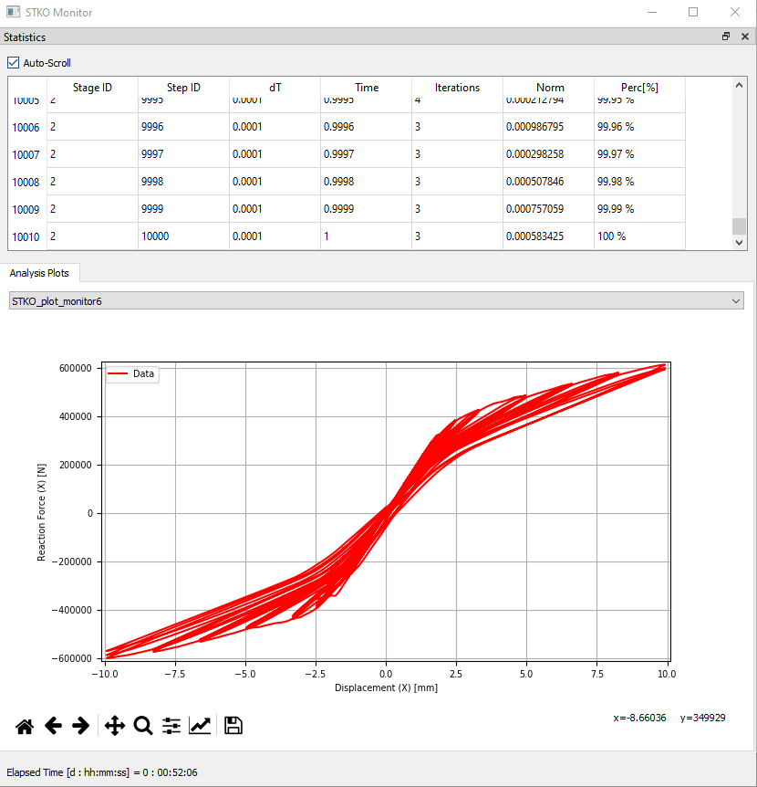

Here is the output of your model:

Thank you very much. Yet, the monitor does not run. I get the attached message and the analysis does not go further. If I delete the monitor it is ok.
