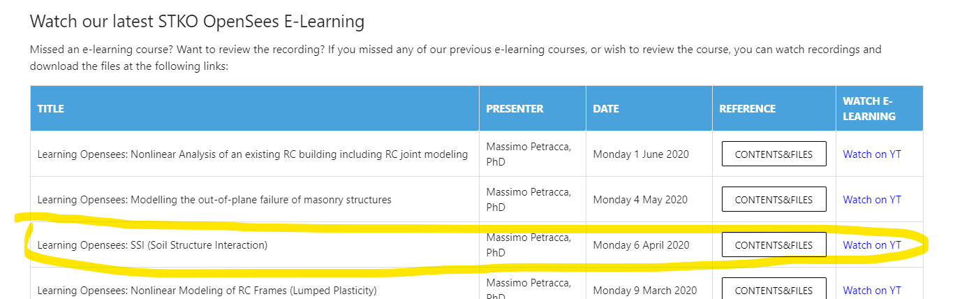

That example is quite old, I don't have that exact SCD file anymore. However we recently gave a webinar about SSI with absorbing boundaries which is exactly the same, but more generic (it is a 3D example)
On our website you can visit the e-learning wepage were we keep track of all previous webinars with links to the video recordings and to download the input files:
https://asdeasoft.net/?stkowebinars-for-opensees
If you instead need exactly that 2D example, I could replicated it as soon as possible.
