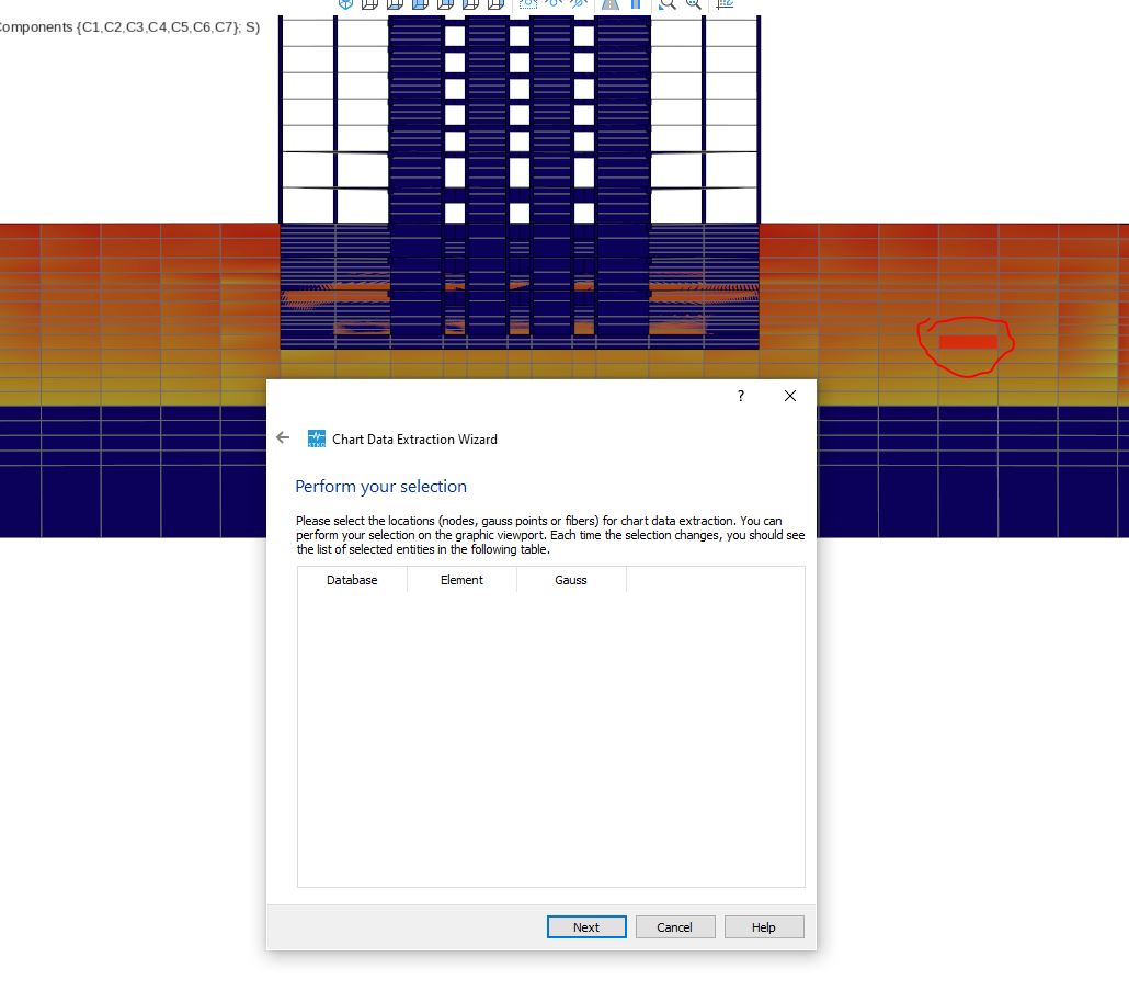

3) How can I visualize strain and stress results from individual soil elements modeled with stdBrick and UCSD soil material models? The results are recorded in the recorder, and I can visualize them. But when I try to plot strain or stress from a soil element using "Chart Data" option. When I select an element, it doesnt appear in the list of the processing menu (see screenshot below).
- Capture.JPG (98.4 KiB) Viewed 3662 times

[3] Have you chosen the Gauss point for extracting the stress-strain response? I recommend trying the Gauss Point plot as stress-strain data can be extracted directly from the Gauss points.

[3] No, you are selecting it on the surface plot. Instead you should go to the Gauss Plot -> Select the Gauss point -> Chart Data -> On Element Gauss Points -> X-Data, Use a result, Strain -> Y-Data, Stress

3) Thanks for clarifying, I think I made it work.
