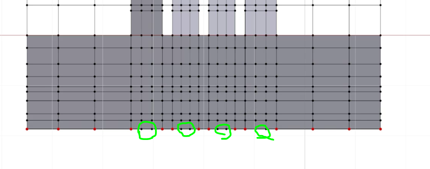

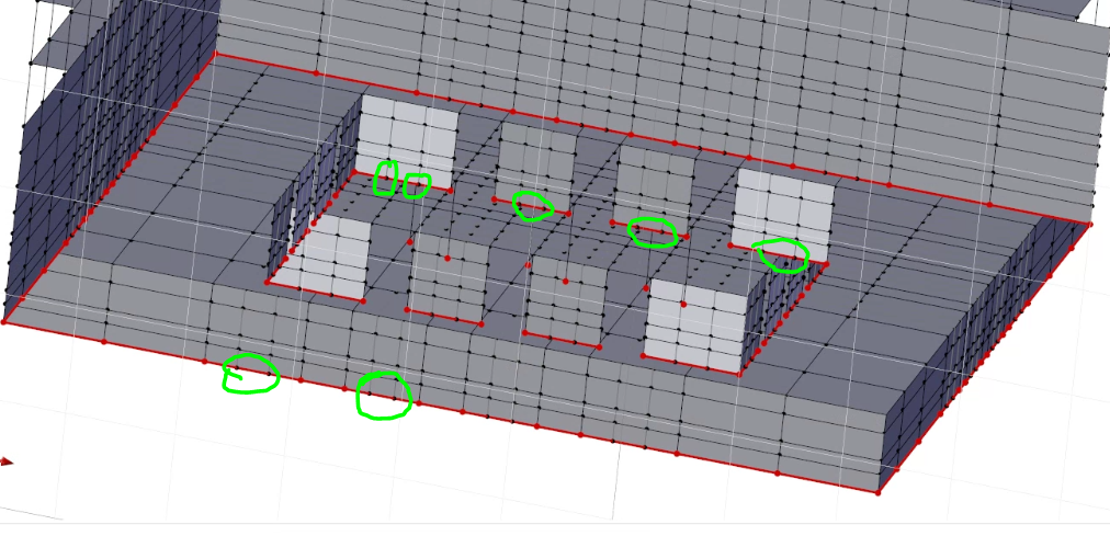

Thank you for your suggestion. I discretized the model into more elements, but I am having a doubt about the results processing. I am using Monitor option to record results of the pushover analyses. However, when I discretize the mesh, it appears that base model nodes are not in the selection set that I use to record the base shear (see green markup in the screenshot below). When I try to select these nodes in the Mesh tab, I cannot. I am worried that the Monitor option is not recorded the entire base shear, but only base shear from some nodes. Please advise how to fix this issue.
That's because you used VERTICES in your monitor selection sets.
Instead, you should select all the fixed EDGES, if you want to record reactions from all the mesh-nodes associated with the fixed edges.
Keep in mind the analogy between the STKO's CAD geometry and the associated Mesh (OpenSees's nodes and elements).
That's the strength point of geometry-based modeling. You select an EDGE, and when you refine the mesh, you will automatically get the associated mesh nodes, without worrying about their numbering

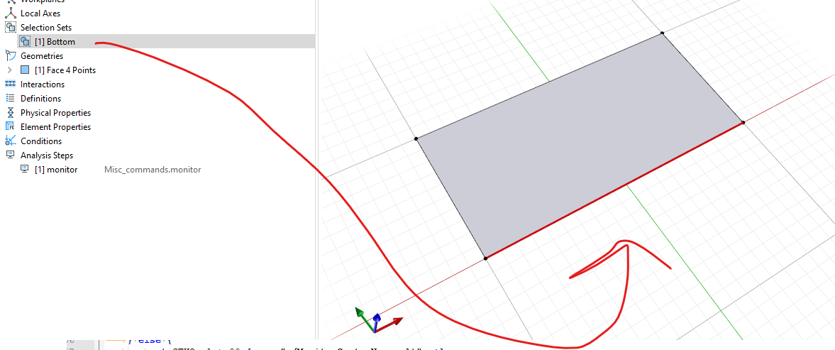

Thank you for your suggestion. I did what you said, but this does not appear to fix the issue. Please see screenshot below. I have added all edges to the selection set, but the meshed nodes still appear unselected when I choose "select" from the selection set.
Don't worry, that's just visualization:
If you add an edge to a selection set, in the mesh I will select (visually) only the edges

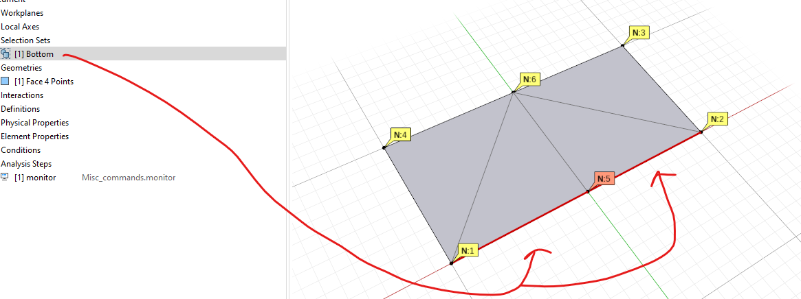

Look at this small example:
1 selection set with 1 edge selected:
In the mesh tab, I have that edge discretized with 2 elements and 3 nodes (1, 2, and 5). If I select the selection set, I only select the elements:
But the monitor requires nodes, so it loops through the elements and gets a unique set of all those elements' nodes.

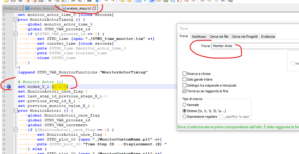

You can see it in the analysis_steps.tcl file (search for # Monitor Actor [<the id of your monitor analysis step>])

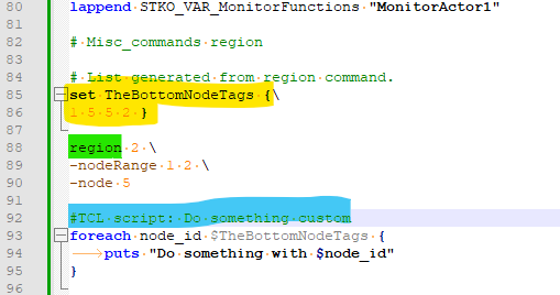

Finally, you can also use the selection set to programmatically do custom operations on mesh entities:

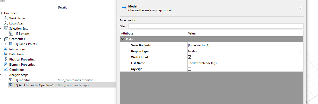

Make a region and ask for a Tcl list of the entities:

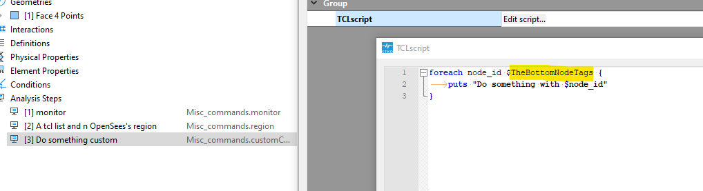

Make a custom script to use the list:
This is what you get:

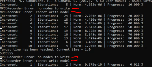

Hello, I am getting the following error (see screenshot) when running one of my models and I am not sure what it means or how to fix it. I think that due to this error, one partition with results ends up being invalid so I cannot process my results. I have MPCO recorder for element selection sets only where I am saving coupling beam rotations. This is same model I sent you earlier via email regarding convergence errors, so you should be able to look at it.
