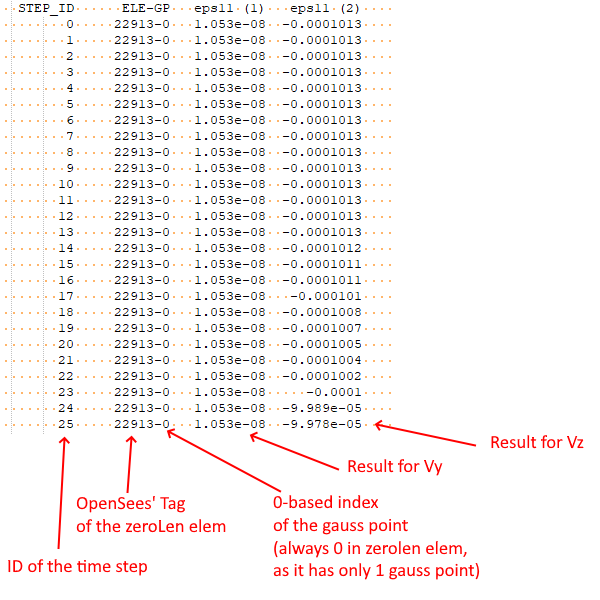

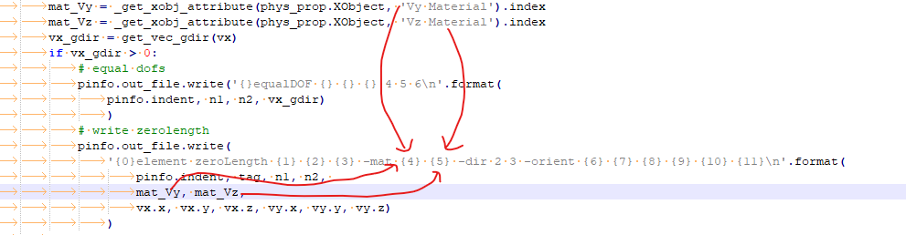

A zeroLength element is a collection of multiple uniaxial materials (2 in your case, the first one is for Vy and the second one is for Vz).2) Assuming that option 3 is correct choice in item 1, there are two columns of results for each coupling beam "eps11 (1) eps11 (2)". What are these referring to? Why eps11?
In OpenSees, any uniaxial material that do not handle the "stress" or "strain" in their setResponse, will fall-back to the base-class implementation, that used "eps11" as label for the unique component (see UniaxialMaterial.cpp, line 250):
// strain
else if (strcmp(argv[0],"strain") == 0) {
theOutput.tag("ResponseType", "eps11");
theResponse = new MaterialResponse(this, 3, 0.0);
In your specific case of BeamWithShearHinge:
- eps11(1) (or sigma11(1)): shear displacement (or shear force) given by the uniaxial material Vy
- eps11(2) (or sigma11(2)): shear displacement (or shear force) given by the uniaxial material Vz

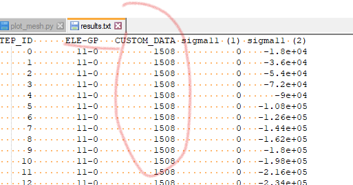

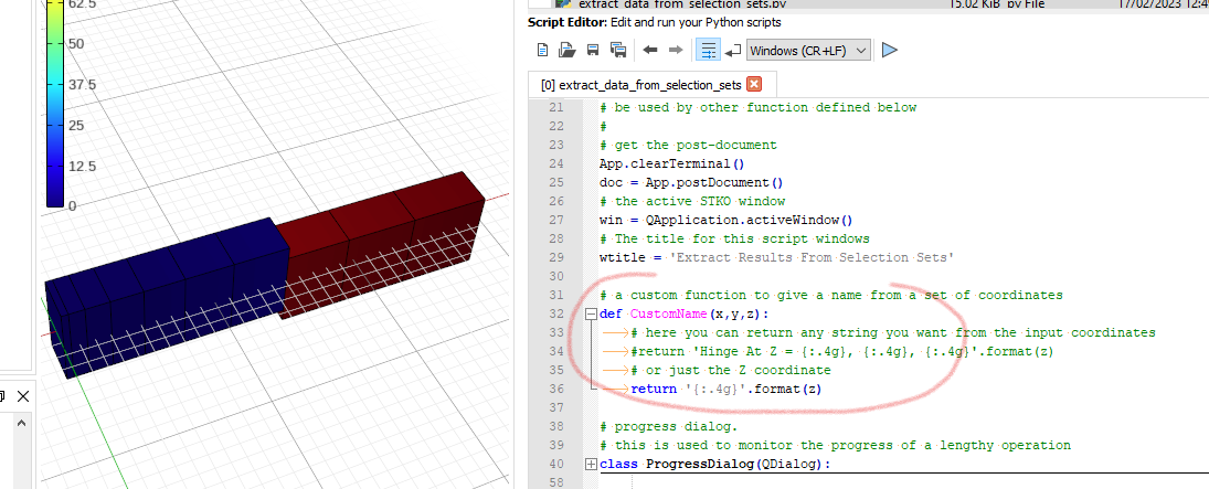

ELE-GP column will give you information about the zeroLength element: The script could be further improved by adding a new column with a custom name (string) for the ELE-GP combo. This name could be a user-defined function of the X-Y-Z coordinates of the centroid of the element. In this way, based on the coordinates you can identify a name (like beam-first-floor-front-facade)...3) Since I have multiple coupling beams in selection sets there is a number of columns with results corresponding to each coupling beam. How do I know which column corresponds to which coupling beam? I don't see any identifying information in this regard as they are all called "ELE-GP".
Thank you for the clarification, that makes more sense now. I need to plot maximum coupling beam rotations over the height of the building. To do that, I need to know the location of each coupling beam. Currently, the output gives tag of the zeroLength element, which can be related to the node, which can be related to the Z coordinate. The issue is that information about zeroLength elements is accessible only in elements.tcl, but it is not very easy to extract it as there is a lot of code around it. Is there a way to export all zeroLength element tags with nodes in a table format? Without this, I am not sure how can I create the plots that I am looking for...
Please let me know. Thanks,
Try this:
Put whatever you want in this custom function:
And you will have an extra column after the ID of the Hinge with your custom name:
That's perfect. Thank you.

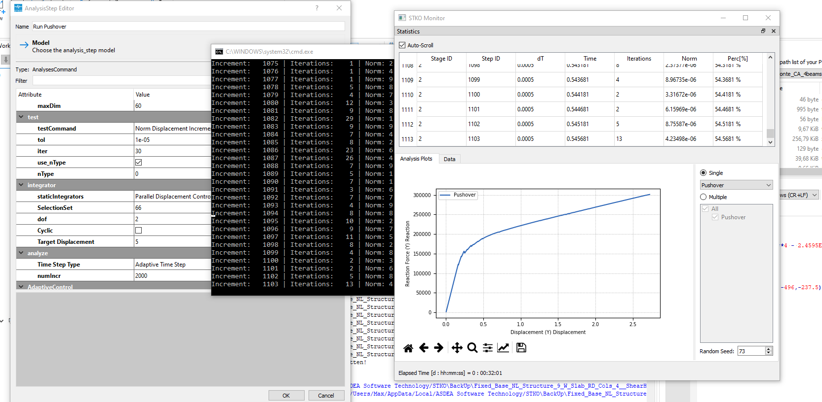

Hello there. I am still working on my coupled wall building. Currently, I am trying to run a pushover analysis - I have setup the model the best I could, and the model seems to run OK, but it is not able to converge to much of a roof displacements. Analysis fails after just a few percent of progress. The models runs fine for dynamic analyses (although without rigid diaphragms).
Can you please take a look at the model (attached) and let me know what you think? Is there anything I can do to improve its convergence?

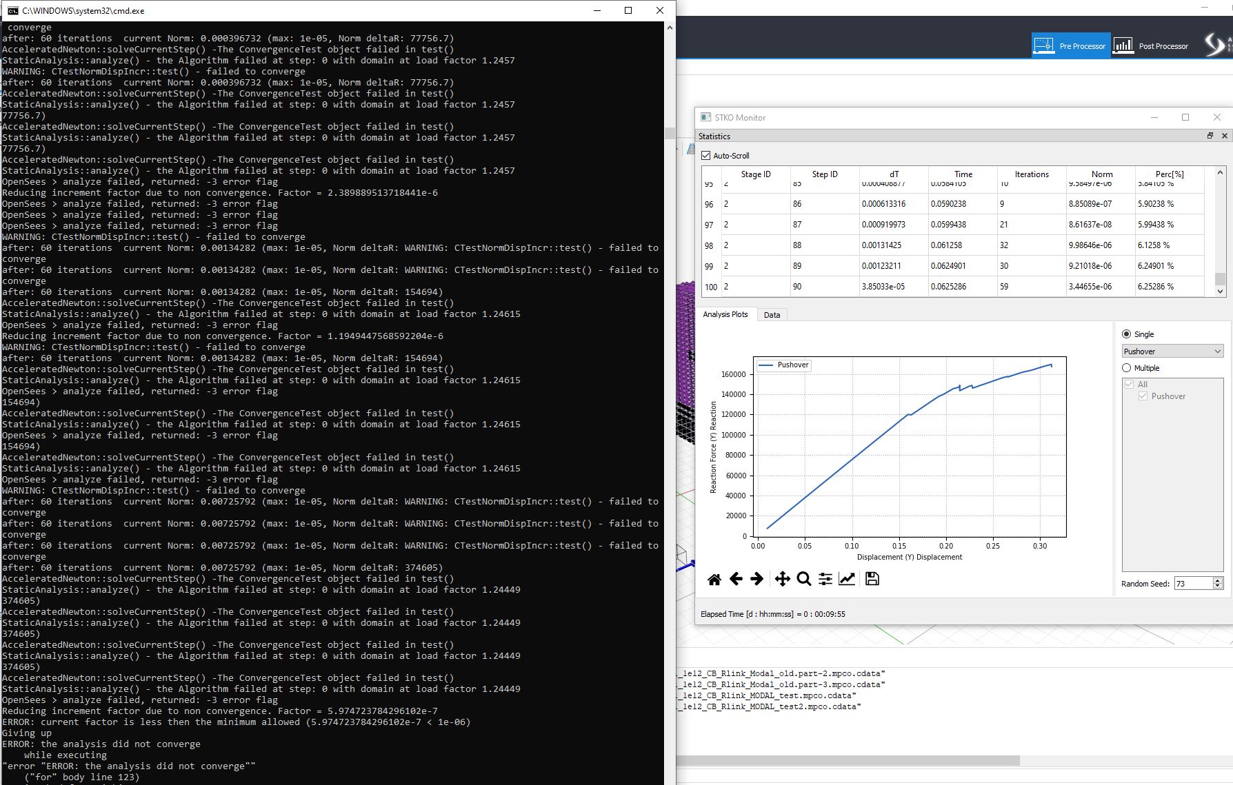

You can improve convergence in Disp-Control analysis by choosing a reference load such that the lambda (load multiplier computed by the Disp-Control analysis is about 1, i.e. not a huge nor a small number).
In your case, you can use the -fact of the "Add Pushover Load" set to 10000.
Then I also increased the number of iterations of the last analysis (it was 10, but are not enough for Krylov). I also had to decrease the error tolerance. When it's too high it can cause accumulation of error.
- Fixed_Base_NL_Structure_9_W_Slab_RD_Cols_4__ShearHingeBeam_2__2_Dmp_Rgn_Anal_1e12_Gravity_Pushover.zip
- (2.89 MiB) Downloaded 369 times
Thank you for quick response. Unfortunately, this didnt fix the convergence issue. The model still fails at around 6% of progress. Any other suggestions? Can I implement somehow the resolution strategy? Again, the model works well for dynamic analysis.
- Capture.JPG (419.63 KiB) Viewed 3862 times
Probably I sent you the files without this last change.
Try the 0-norm. It basically says that the tolerance in the test command is satisfied if all DOFs have an abs(error) < tolerance.
Instead, with the usual L2-norm, you enforce the norm of the vector of errors to be less than the tolerance. But when you have lots of DOFs, this norm can grow proportionally to the number of DOFs.
