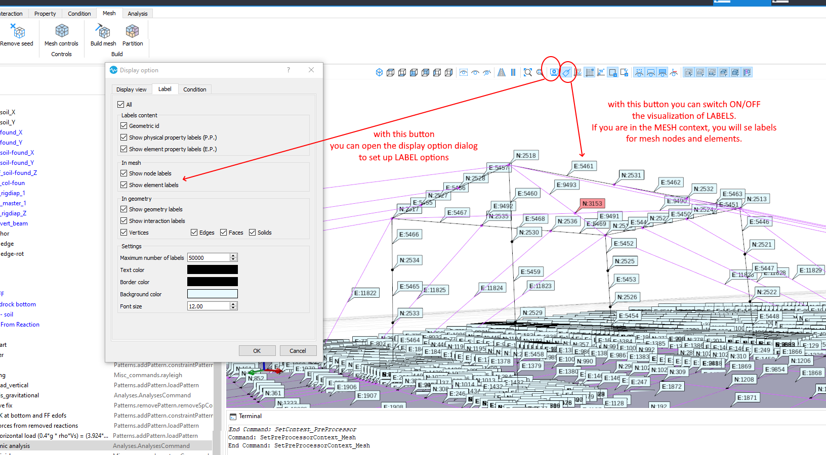

Also, linked to this, I just wanted to make a suggestion since you will release another version of the software. When I want to identify a node (ID node), I do it by using the query vertex option. However, there is not such an option for the elements like edges. I am used to write my records manually to obtain the forces, drifts and so and so to check them in MATLAB. It would be nice to have an option that can do that work... Because I have to do it manually (searching in the tcl file)...

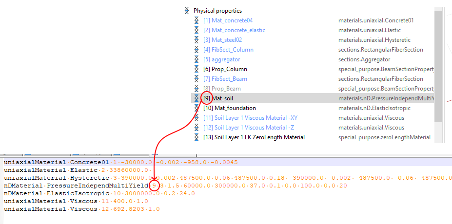

You are right, it would good to have it automatically, we put it on our to-do list.Thing is that I had to check in the imput file the tag of the material... It would be nice to do that automatically. It did not take me a lot of time because I only have one material like that one. However, there might be some cases with a lot of different types of materials.
However, in the meantime, it is not necessary to look into the generated TCL files to know the tag of the material: the tag will be equal to the Physical Property ID in the STKO's pre-processor Work Tree:
If you have the latest STKO version (1.1.5) you have this feature. It's called LABEL:When I want to identify a node (ID node), I do it by using the query vertex option. However, there is not such an option for the elements like edges.

Wow!!!! Thanks a lot. I did not know about the Label Option. It is going to save me a lot of time working...

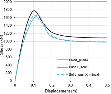

I have divided the edges in 3 divisions so that the mesh is more discretized. I have run the analyses and if I consider the gravity analysis, the pushover analysis does not start... I have increased the number of iterations in the pushover analysis but I obtained no results.
If I only consider the pushover analysis, the model works correctly and the pushover curve is something like this... I am astonished with the decrease of the pushover curve. I am now worried about such bad behaviour

I think your results make sense. Does the soil become inelastic? The high flexibility is probably due to the soil inelastic behavior
