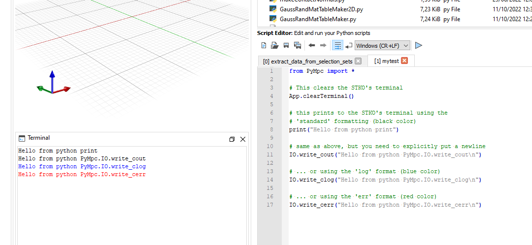

Post by STKO Team » Wed Jan 25, 2023 7:54 am
You can print to the STKO's terminal. Inside the STKO's environment, the Python's print is redirected to the std::cout, and thus to the terminal
from PyMpc import *
# This clears the STKO's terminal
App.clearTerminal()
# this prints to the STKO's terminal using the
# 'standard' formatting (black color)
print("Hello from python print")
# same as above, but you need to explicitly put a newline
IO.write_cout("Hello from python PyMpc.IO.write_cout\n")
# ... or using the 'log' format (blue color)
IO.write_clog("Hello from python PyMpc.IO.write_clog\n")
# ... or using the 'err' format (red color)
IO.write_cerr("Hello from python PyMpc.IO.write_cerr\n")
