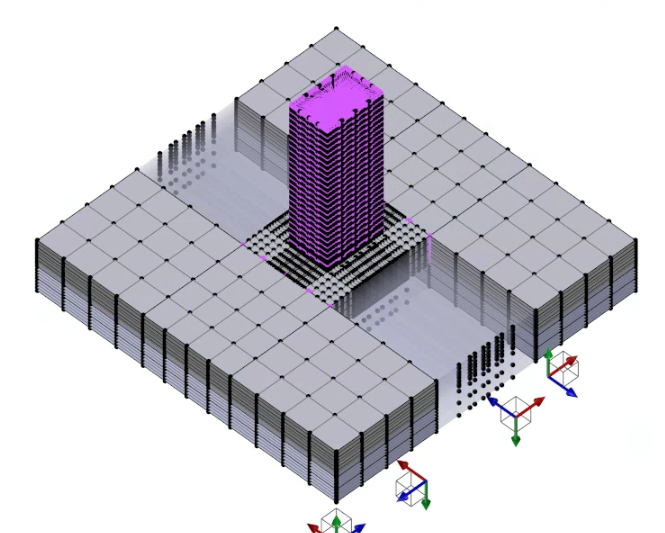

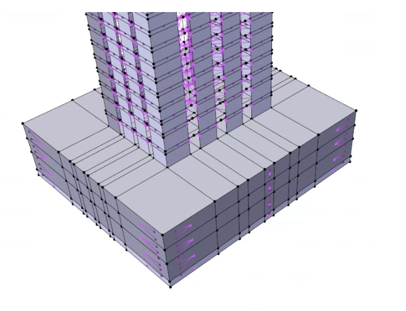

Hello, as I am continuing to refine my SSI model I am running into more issues and I would appreciate if you can help.

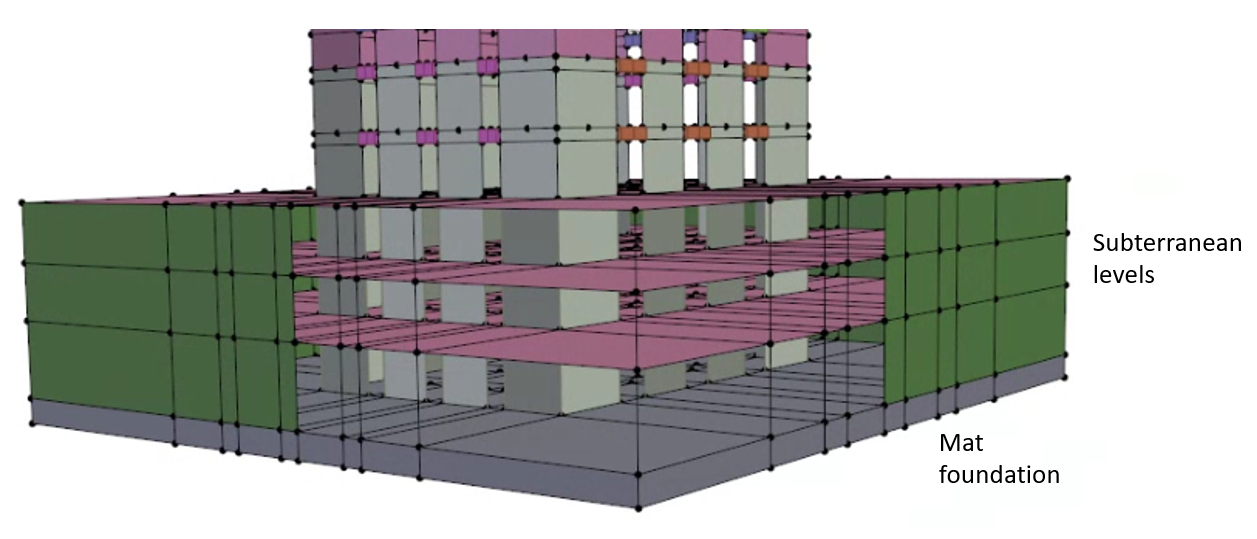

I am currently trying to model subterranean levels more realistically as they were currently modeled as a rigid foundation block (see 1st figure). In order to connect all walls to the basement level slabs, I have decided to divide the geometry so the slab and the walls connect (see 2nd figure) - that way I don't have to use embedment penalty constraints as I did in the previous iteration. However, this seems to complicate modeling of soil foundation contact, which is what I am currently struggling with.
It would be great if you can answer my questions:

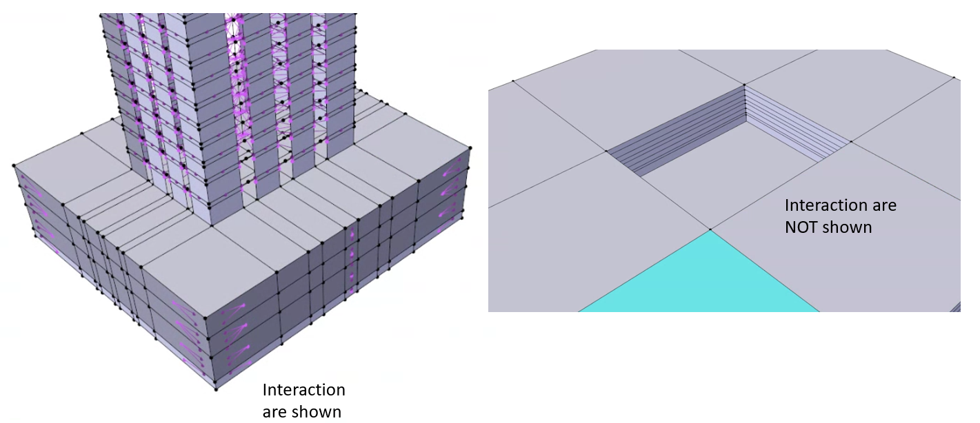

1) I have created contact interactions for each face of the foundation-soil interface (X+, X-, Y+, Y-, Z-), However, it's graphical representation is different than before. The interaction shows only on foundation, but not on the soil (see figure 3). Is this normal? Did I make a mistake when creating these interactions? I am assuming this is because the geometries are not perfectly aligned. Btw, I found it was very challenging to select slave and master geometries because the faces are at the same location and I have created selection sets to do it. Please advise if this is correct way to do it.
2) Related to the previous topic, does it matter which one is master vs slave geometry when creating interaction (foundation vs soil)? which one is preferred way to do it?
3) Regarding contact elements, I used to use "From local axes option". However, this requires defining local axes and assigning them, which is a bit cumbersome. Does local axes need to go from master to slave or they only have to be aligned with the surface? Would using "From link direction" be correct in this case and would that be sufficient to make it work?
4) Finally, I receive an error that "Different NDF on same node". I used to have this error when I tried to connect beam to a solid, but this is not the case here anymore. It is possible that this is now because I am connecting a wall (shell) to mat foundation (solid). How do I solve this issue?
I attached the model for your convenience. Thank you very much!
Sometimes, when there are a lot of faces, we simplify the representation of interactions in the Geometry View. To visualize them correctly switch to the Mesh view. Do your mesh and check the interactions, you should see all of them.

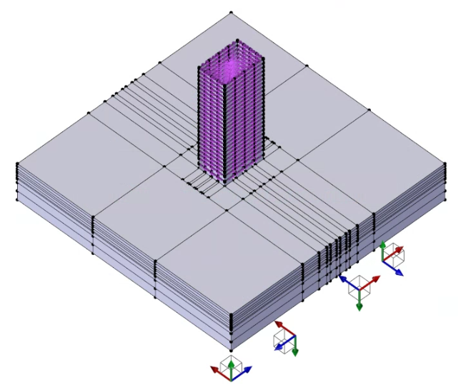

Thank you for quick reply. I have a few follow up questions.
If you are using compatible meshes (foundation and soil have a node-to-node alignment), and therefore you are using a node-to-node link, there is no difference. You only have to pay attention to the contact normal direction: IT SHOULD GO FROM MASTER TO SLAVE
I am not using compatible meshes, which you can see in Figure 3 from the previous post, where soil and structure have different geometries, and therefore different meshes. It might be possible, but pretty difficult to make the meshes compatible. Is this a problem? Is there any simple way to make meshes compatible?
In case meshes need to be compatible, it seems that I should divide geometries of the soil in the same way as I divided geometries of the basement structure. Is there any easy way to do that without having to re-do the entire soil domain? Is there a way to simply "split" the soil geometries?

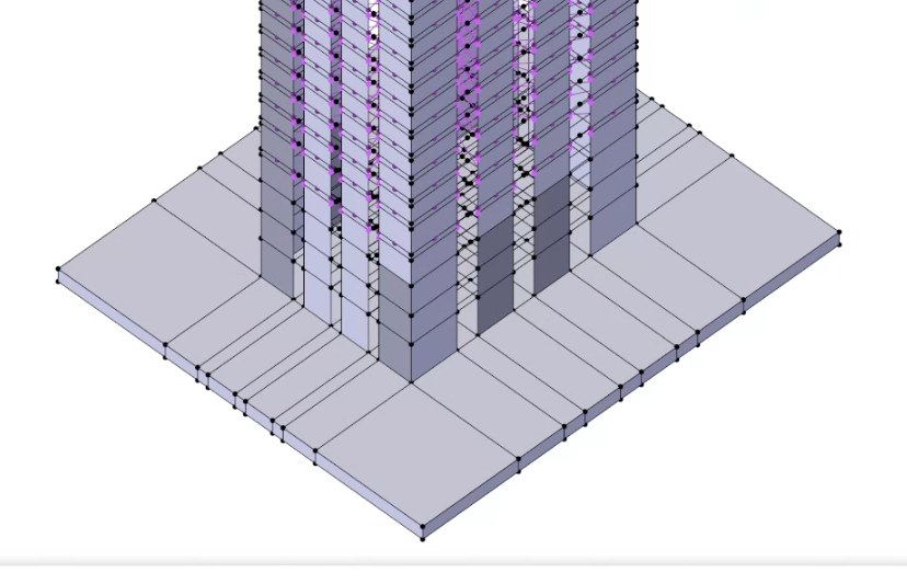

Hello, I am working on aligning mesh between the soil and the basement levels/foundation, but I am running in some issues. I draw faces through the soil domain and performed MERGE command as you suggested in one of the other posts, and the geometry looks fine (see figure 1 below). However, when I create mesh I encounter an error saying "MpcSolidMesher error: front and back faces have incorrect number of elements (!= nx*nz)" (see figure 2). I am not sure why is this happening and what to do to fix it.
Regarding creating equalDOFs to connect walls to slid elements of the foundation, I am not exactly sure what needs to be selected as a master and what as a slave (see figure 3 below). Do I select foundation solid as a master and wall face as a slave or do I select foundation solid as a master and wall edge as a slave, or any other option is appropriate. Please advise.
