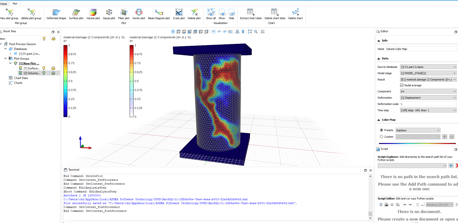

Although I can successfully run the model prepared by STKO, I can not obtain the cracked shape as shown in RAND_MAT_2.png in this web page (see Deformed.png).
How can I see the cracked shape?
P.S. I do not know whether to be used any external any phyton file or not.

Just increase the deformation scale factor in the plot editor
