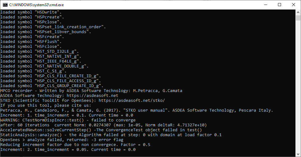

Dear STKO team
Thank you for suggestions!
I remeshed the model, but I still can't partition, So I planned to use the openseessp to calculate, but it could not converge and it took too much time to calculate for one increment.
Can you help me check what's the problem?
THANK YOU VERY MUCH!
The figure is the information of the mesh and the error of the calculating procedure.
屏幕截图 2022-01-21 200634.png (10.89 KiB) Viewed 3364 times
屏幕截图 2022-01-21 200418.png (49.51 KiB) Viewed 3364 times
And I also attached the remeshed model, this is mesh side is larger than the last one.
case1.rar
(14.99 MiB) Downloaded 177 times
It looks like there is an issue in partitioning the 2 solids when their mesh size is so different. It will take a while for us to find the source of the issue.
When can you solve this problem? If you finished it, could you please inform me in time? Thank you!

I remeshed the model, it can be partitioned now.
The outer-soil: grid size is 10m in X-Y plane, and the inner-soil: grid size is 1m in x-y plane, and the basement box: grid side is 1m in X-Y plane. The whole model gird size in Z direction is 5m. Based on this mesh size, the node number is 192155, the element number is 533181.
But it failed in analyzing. What is the problem? Can you help me modify it.
I uploaded the model to the Google Drive. https://drive.google.com/file/d/1n9MZ6Y ... sp=sharing
I need your help urgently.
Thank you very much.
屏幕截图 2022-01-22 101941.png (112.07 KiB) Viewed 3364 times
