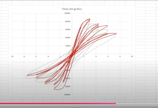

Hi, thank you very much. Everything worked. But when I get to the calculations, the results come out with a linear progression. The gradient should have this shape. I tried the character. Reduce values ​​but the results still remain the same. Do you know where that could be?

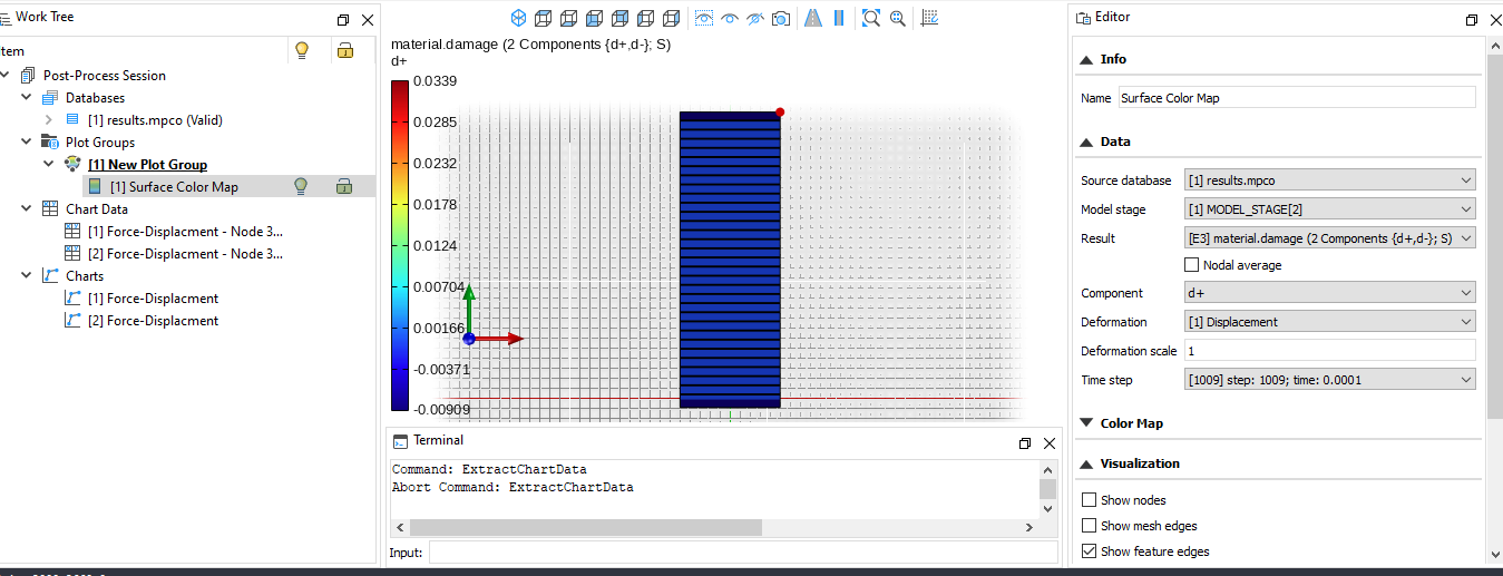

Post by Jamildouier » Sun Oct 27, 2024 10:20 pm
It looks like this. I even tried playing with the vertical loads, the damage parameters and the character values ​​but it still doesn't work. Is this due to the model itself, so that the graphic does not look as intended or no matter what the model is, does the graphic have to look like the one above?

Hi, Please check it under "Gauss point plot"

Post by STKO Team » Thu Nov 07, 2024 12:17 pm
The damage is really small so it makes sense you see an almost linear behavior. Please check that you are imposing the load correctly or that the material parameters are correct. Or share your file
