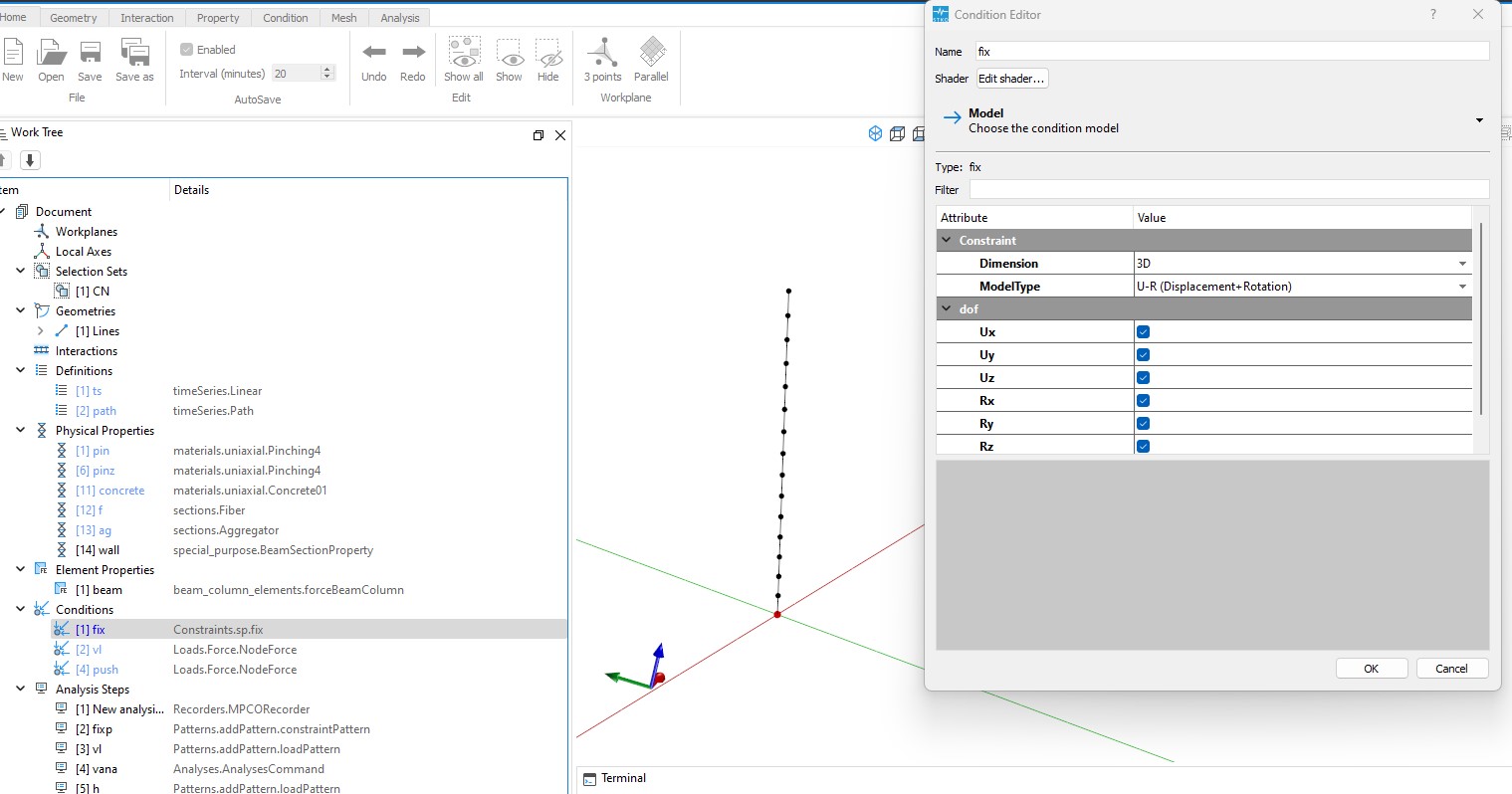

1. you didn't assign conditions to your model. You added it to the analysis in a constraint pattern. But it doesn't know to which point of your model you wanted to apply it. Also, you can see that after you assign conditions they will change the color, so in the future, it will help you to avoid this mistake.
Screenshot 2023-03-14 100642.jpg (162.26 KiB) Viewed 3607 times
2. you used the duration 6.1 in your push analysis, I think you don't need it. You have your time path that is already 6.1. Also, check the value that you applied. You are using 1 unit force with load control.
3. you can use plain constraints in the analysis as your model is very simple.
4. check if you are coherent with the units of measure that you are using.
Valentina

1. you didn't assign conditions to your model. You added it to the analysis in a constraint pattern. But it doesn't know to which point of your model you wanted to apply it. Also, you can see that after you assign conditions they will change the color, so in the future, it will help you to avoid this mistake. Screenshot 2023-03-14 100642.jpg
Valentina
Oh My God, the first question really shouldn 't. I am too careless. If i used penalty method ,the displacement can only reach 6 mm. If i used plain constraints, the result is strange, Like the attachments. When I use penalty method, where can I modify?
