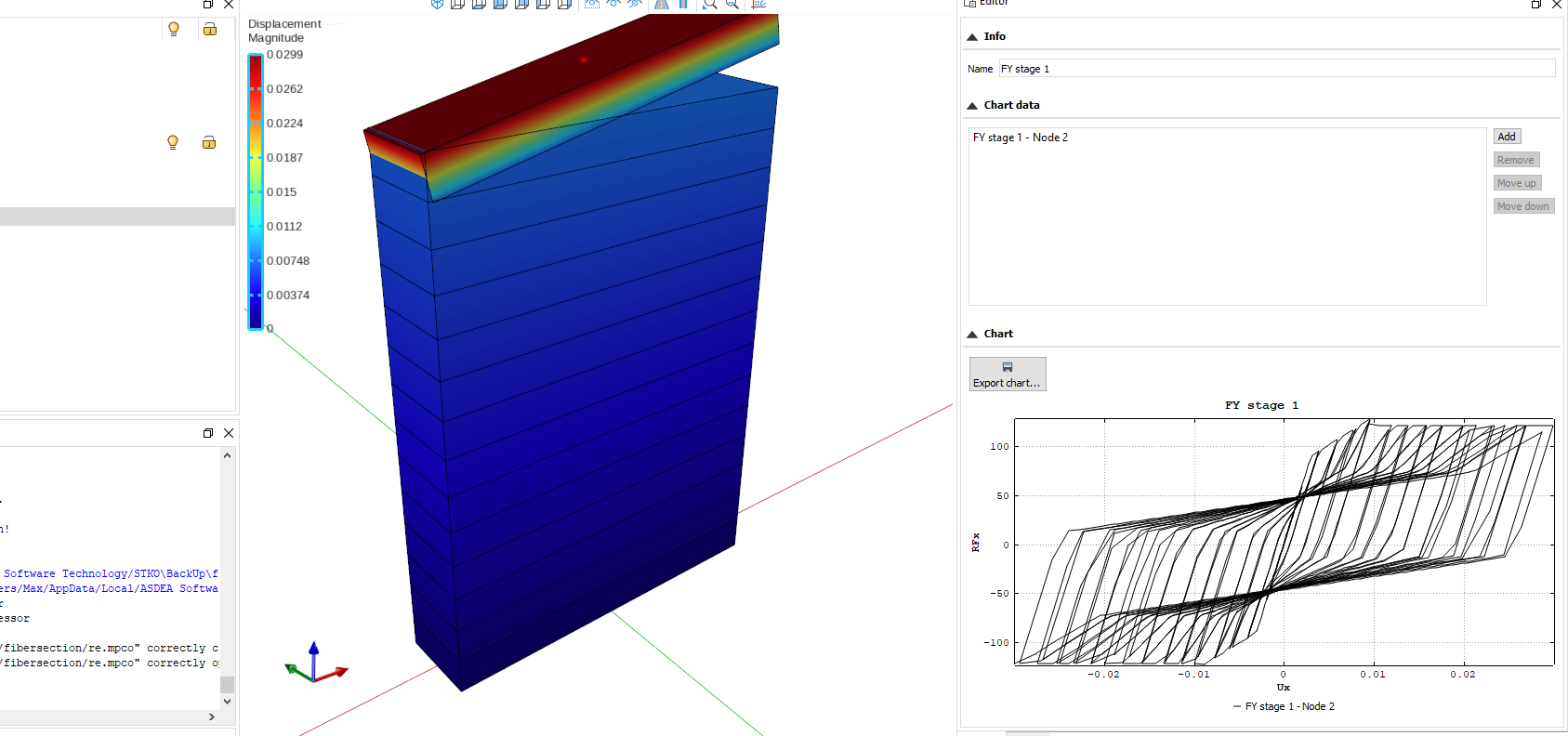

Oh My God, the first question really shouldn 't. I am too careless. If i used penalty method ,the displacement can only reach 6 mm. If i used plain constraints, the result is strange, Like the attachments. When I use penalty method, where can I modify?ValentinaSB wrote: ↑Tue Mar 14, 2023 9:09 amHi Wenyu,

Thanks for your answer!But Whether using transformation method and modified newton or penalty method, the result is still the same as the picture. It has a tendency of hysteresis, but does not complete the cyclic loading. Actually, the maximum displacement of the experiment is 15mm. Is this because the material value I set cannot make the structure reach its due bearing capacity?STKO Team wrote: ↑Tue Mar 14, 2023 6:02 pmtry this:

Your analysis terminated correctly (in fact it reaches 100%).
The problem is another:
Your cyclic time series has 61 points (so 60 segments) with a dt = 0.1, the total duration is 6 seconds.
But in your analysis, you set a duration of 1.0 seconds. that's why it does not complete the cycle.
Just use, in your time series, a dt = (1/60) = 0.01667:

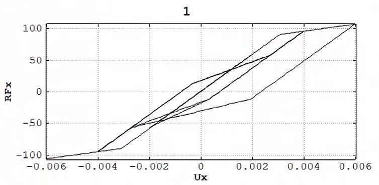

1. As shown in the picture,The stress-strain curve of pinching4 material has an unclosed straight line at the beginning. What is the reason, Does it affect the calculation? how to modify it ?

It's because you are using too few sampling points. Increase the Divisions in the material tester to have more points in the chart1. As shown in the picture,The stress-strain curve of pinching4 material has an unclosed straight line at the beginning. What is the reason, Does it affect the calculation? how to modify it ?
