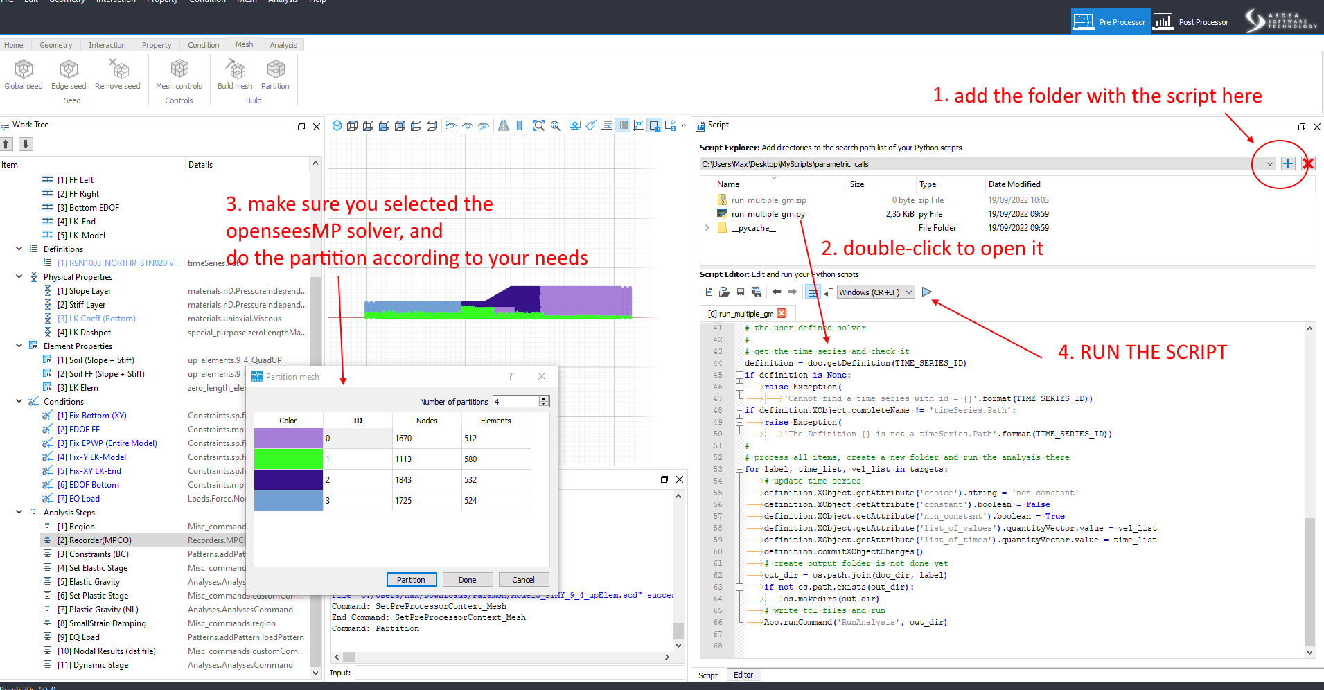

If you don't know how to use it, please first have a look at this webinar: #20 Intro to STKO v2.0's Python API
Note: I'm using the latest version of STKO (3.1.0) and the latest version of the OpenSees-Solvers from prof. Tarque's webisite
Here's the python script:
run_multiple_gm.zip
(1.09 KiB) Downloaded 172 times
Download it and unzip it into whatever folder you want. I typically have my own folder for useful scripts.
Once you have it, you can add this folder into Script Explorer, and double-click on the file to open it:
param omp.png (239.6 KiB) Viewed 2201 times
The output will be a collection of folders, with the same name found in the GroundMotionSets directory.
Inside each of them, STKO will write the TCL files and the output files from OpenSees.
WARNING: I've seen that you are accessing a file from a custom script. Now each OpenSees will run inside those sub-foders, so you may want to change the name of the file to match the real location of the file.
for example, if you file is in the parent-directory, you could use:
set channel [open "../nodeInfoSlope.dat" r]
Let us know if it works
