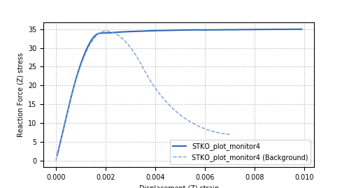

Thanks for your clarification. The Gc value I estimated from the reference is 17.3 N/mm (fc=34.5Mpa), but the results of my model are very different from the results of the stress-strain curve obtained from the "material test", is this the reason for my model?

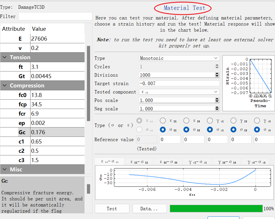

Sorry, I may not have been clear before. Due to the lack of test data. I want to simply test if the concrete parameters are correct. The background curve is the data obtained according to "Material Test" by inputting some parameter values (fc0, fcp, fcr, gc). The specific fracture energy (gc) is calculated by the classical compression full curve model (China code GB 50010-2010).
The fracture energy (Gc=(fc/ft)^2/Gt=17.3) is calculated according to your recommended method (CEB-FIB mode code).

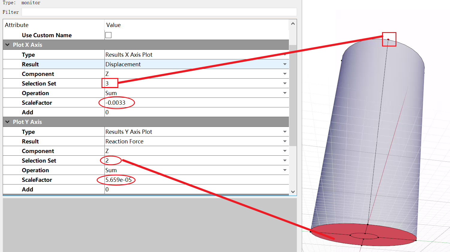

The scale factor calculation process in monitor:
X Axis: dispalcement(set 3)/specimen height(300 mm)=dispalcement(set 3)*0.0033
Y Axis: reaction force (set 2) / area of bottom surface = reaction force (set 2) * 5.659e-05

Ok, so if the China code gives you gc = 0.176, assuming lch_spec = 300 (even though it might be lower, you should check the distance between the LVDTs they used to compute strain from displacement), your Gc = 52.8.Sorry, I may not have been clear before. Due to the lack of test data. I want to simply test if the concrete parameters are correct. The background curve is the data obtained according to "Material Test" by inputting some parameter values (fc0, fcp, fcr, gc). The specific fracture energy (gc) is calculated by the classical compression full curve model (China code GB 50010-2010).
You obtained very ductile curves with that value because this test is (almost) constant strain. It is difficult for a numerical model without imperfections to trigger the localization when the fracture energy is high. Furthermore, you were using the wrong constraints.

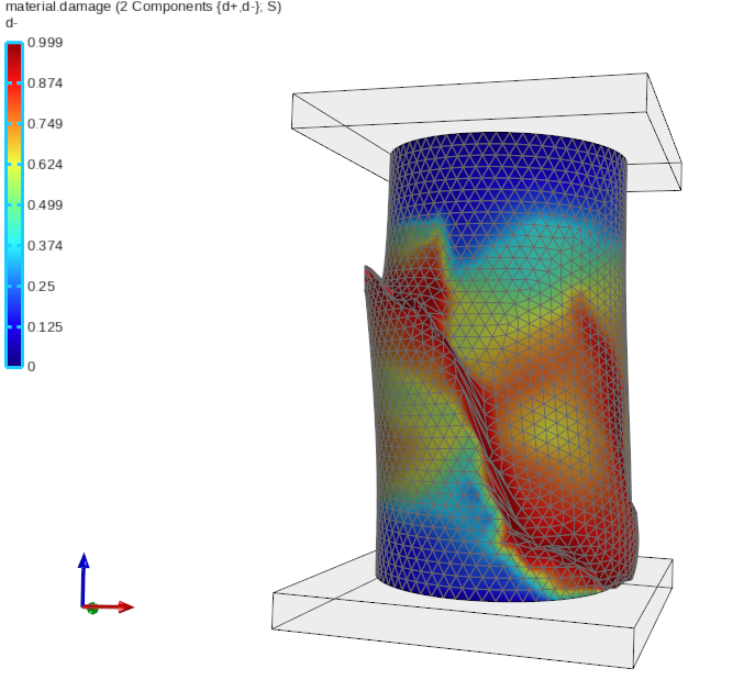

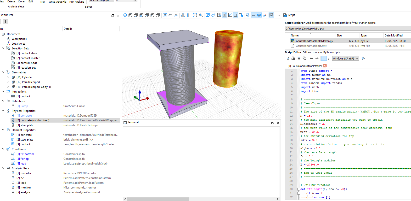

Check the attached model. I used:
- A non-structured tetra mesh, to introduce a bit of imperfection in the mesh
- Steel plates and frictional contacts between the steel plates and the concrete to better simulate the boundary conditions
- Finally I used a Random Material Wrapper to introduce imperfections. I will talk about it in the next webinar about strain localization. But here you can find a preview.

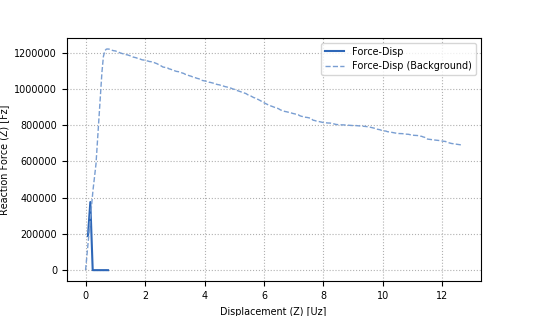

Dear STKO teams,
I built two models of reinforced concrete short columns in compression. The first model built two steel plates following your example, but the results did not converge; the second model used node to node links with interaction and finely meshed the steel plates, but the force quickly dropped to 0. Is there a problem with friction contact?

Dear user,
We detected a convergence issue that has been recently improved in the source-code of the ASDEmbeddedNodeElement. It will be released in the new OpenSees version. The compiled new version with this improvement will be released next week by prof. Tarque, together with a new STKO release.
We will keep you up-to-date.
