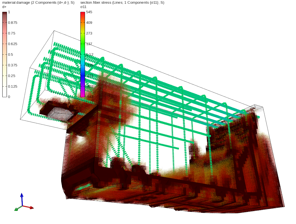

Posts: 131
Re: Load-displacement curve
Post by Clarabella » Fri May 21, 2021 1:11 pm
These are the results. We think that there is a problem with the support.
Regards

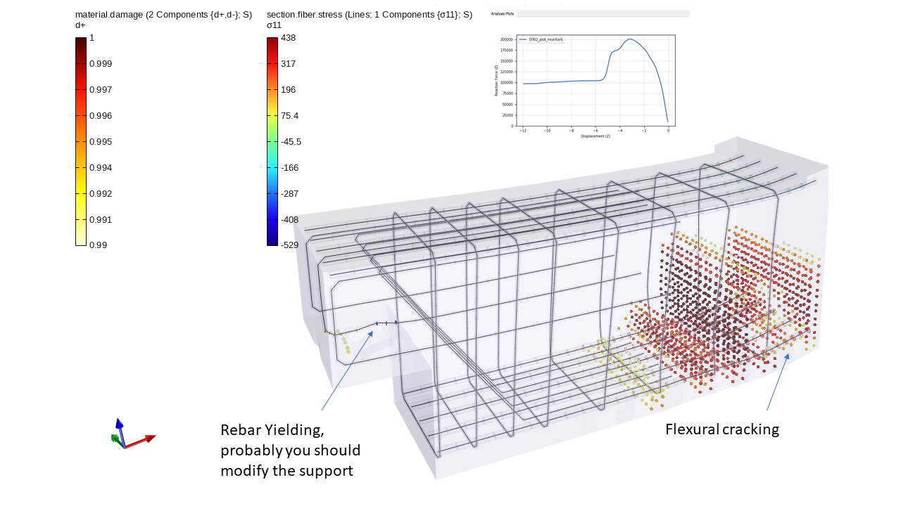

Post by STKO Team » Fri May 21, 2021 3:12 pm
You can also make a finer mesh to visualize better the crack pattern:
Horace Horsecollar
Posts: 33
Joined: Mon Mar 22, 2021 11:42 am
Post by Horace Horsecollar » Fri May 21, 2021 3:22 pm
Cool picture! It is quite evident that the problem is how the support is modeled.
