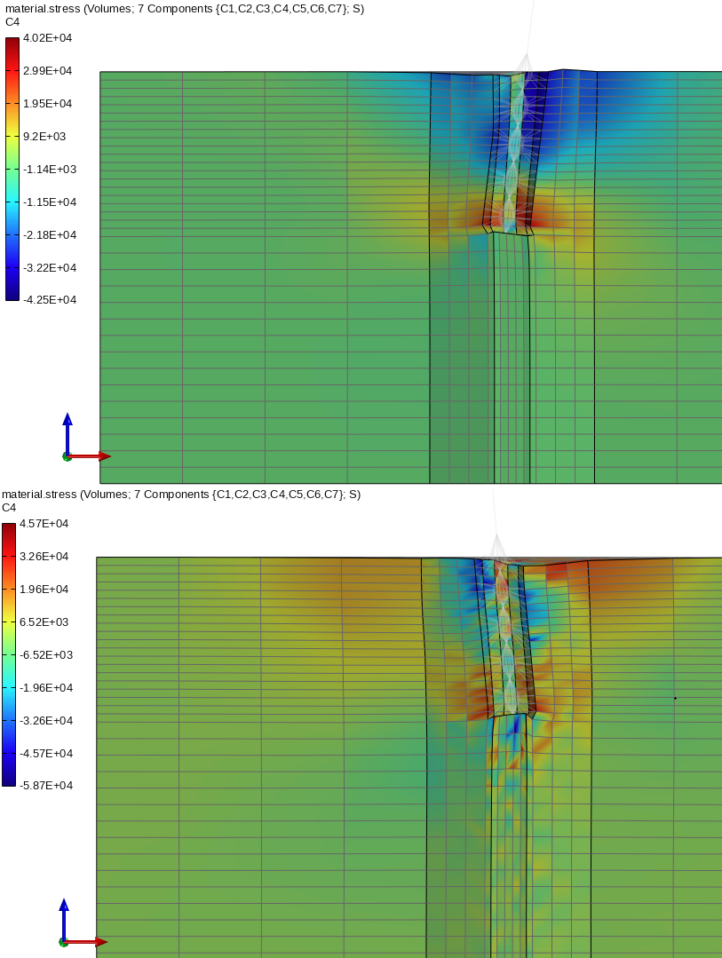

Thank you a lot for the final tunes on the model! I changed the analysis back to transient as it is important for my end goals with this model. I also added a top mass&load to simulate the superstructure's inertia and weight however, the mass of pile was actually applied via the disp.based.beam element already. I also moved the plastic gravity analysis into the InitialStateAnalysis portion of the simulation.
Now it works well however, I have a few concerns on the final model that I've set up. I have attached the model, if you run it and check the results there are a few conspicuous things. I also attached images if you don't have time to run the model.
First there is an upheave of the soil at the pile toe during the cyclic loading. The pile actually displaces vertically upward quite considerably. This does not seem to be physically correct. What may be the issue here? Did I mess up some material parameter again?
Second, in the stress field I see some chaotic distributions and sudden variations between each time step (dt>=0.001s) in the soil elements surrounding the pile . This chaotic stress "flickering" only starts at the first de-loading cycle. Upon the first loading the stresses behave as expected, and they are continuously distributed. I also see some minor vibrations of the soil element edges (when looking at displacements) during and after the first unloading. The contact elements are not completely stable and they make the soil elements surrounding them "wiggle" even though the general displacements and behavior of the system is indeed correct. I assume this accurs due to the algorithm that evaluates whether the pile is in contact with the soil or not, but upon un-loading&re-loading it seems that the algorithm is struggling to decide the contact condition each time step. This is best seen when the results are animated, nevertheless here is an image of shear stresses during the first loading and the first unloading next to each other.
I am not sure what to make of this two phenomena, if any of you guys on the forum or at STKO have a sense of what might be going wrong please express your ideas.

Re: Pile-soil Interaction Convergence
Post by STKO Team » Fri May 28, 2021 4:24 pm
Actually, I noticed this behavior even during the excavation process!
So to understand what was causing the problem, I removed the Pile and Contact, and I removed the last stage, that is, only until the excavation is finished.
I considered 3 different scenarios:
  1. PressureIndependMultiYield - updated to plastic
  2. PressureIndependMultiYield - kept elastic (I commented out the updateMaterialStage 1)
  3. ElasticIsotropic (I used the E and nu derived from your Bulk and Shear modulus)
These are the outputs at the end of the excavation. Scenarios 2 and 3 are equal, which means that the model is working fine in the elastic range because it produces the same results as the equivalent elastic material.
So I think the issue is in your material parameters for the plasticity part. I would suggest double-checking those values.
If you think they are right, try to understand what is causing that volumetric expansion... to much dilatancy? but it seems strange because I don't think your model is going to much into nonlinear stage.
Try to investigate whether this behavior is physically correct or not. Then you can move to the dynamic last analysis-

Post by [email protected] » Sat May 29, 2021 3:09 am
I have noticed it in excavation too. It seemed reasonable to me as, the unloading of the toe region is significant. (120m3 soil removed+60m3 water surcharge) Hence, after producing large stresses in that area during the elastic static analysis I do expect considerable plastic deformation when I switch tonplastic state.
But during the pile lateral loading it didn't make much sense to me, as there isn't any significant unloading of the vertical forces/stresses, so I don't think the soil should upheave as much as it did during the dynamic phase.
Post by STKO Team » Sat May 29, 2021 7:47 am
I think it's in part related to the plasticity issue. I tried to run it with an elastic material and I don't see those huge oscillations.
I do see some small oscillations in shear stress upon load reversal, But I think it's normal. First try to record accelerations to make sure your dynamic analysis is set correctly (correct time step, some damping...). If you see accelerations growing without control, it means that you need to refine your mesh or your time step.
