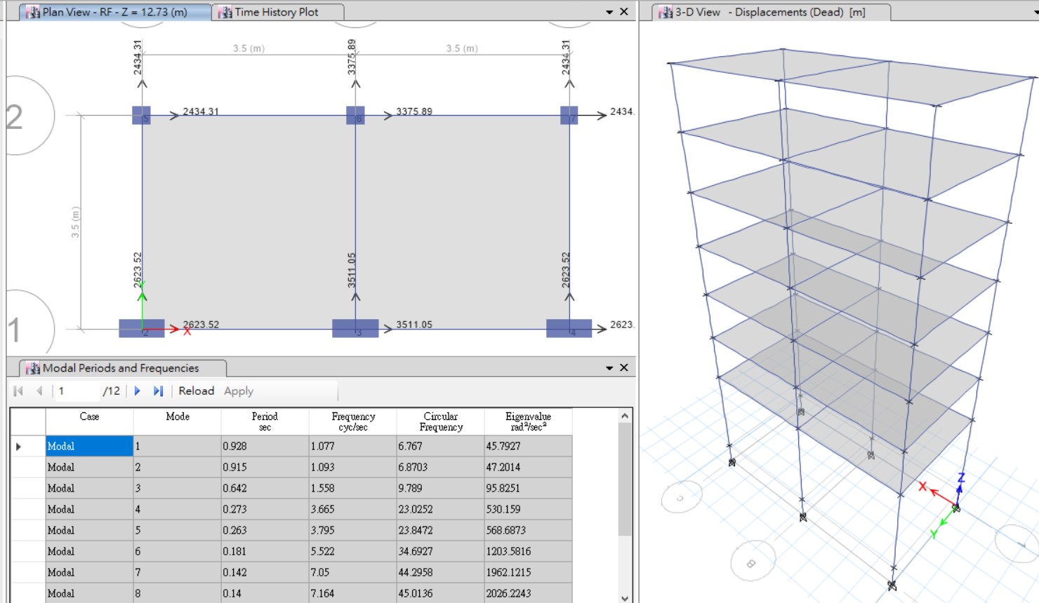

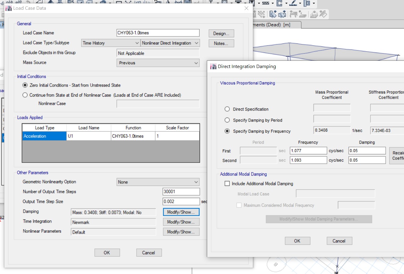

To simplify the comparison, I deleted the shear wall. Then, I did the analysis again and compare ETABS to STKO.
There were some results I found.
1. The two models had almost same frequency (1.07 Hz), so the models was almost same.
2. The results of two models still be different with roof displacement.
Here is my STKO model. What do you think about it?
Any advices and helps that you provide are highly appreciated.
Best Regards

- ETABS period.jpg (173.75 KiB) Viewed 6811 times
- ETABS analyze setting.jpg (188.46 KiB) Viewed 6811 times
- untitled.jpg (31.67 KiB) Viewed 6811 times
