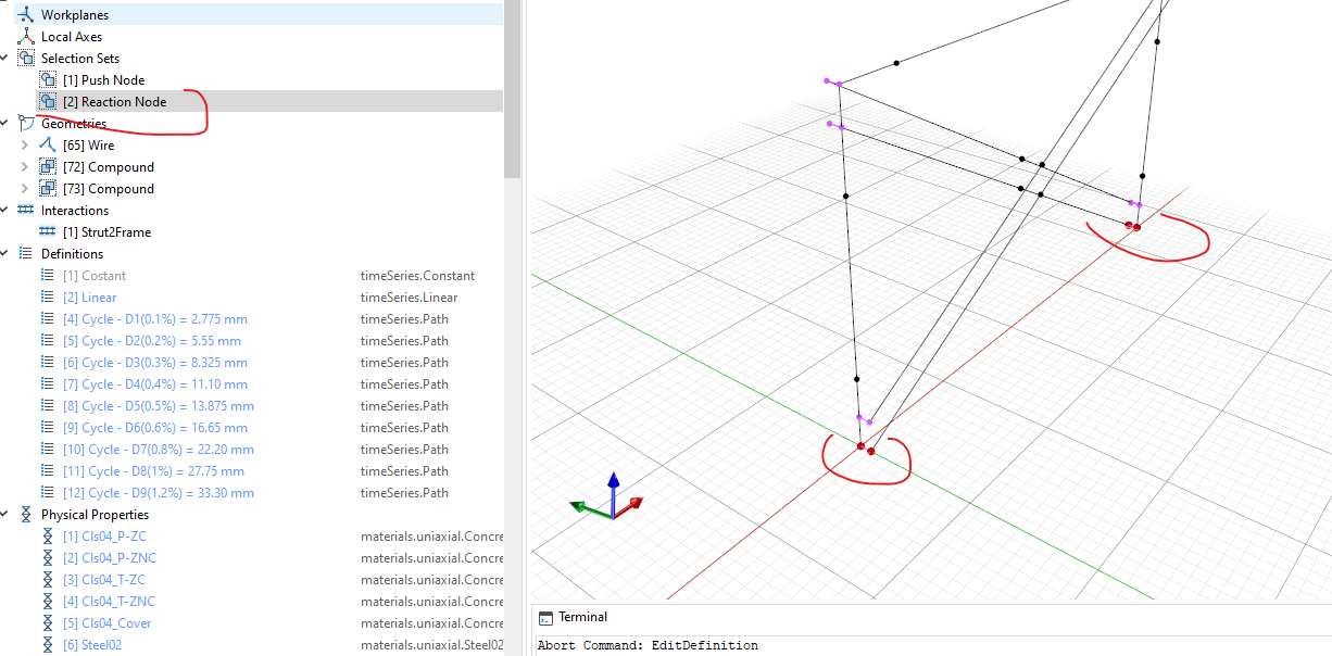

  • When the fixed node is connected to other nodes via MP-Constraints, reactions go on the slave nodes. If you are not sure who is the master and who is the slave, just put all of them in the reactions set
  • Tip for improving convergence: When you do a Displacement Control analysis, the load multiplier is an unknown of the problem. It's better to start with a reference load which is close to the expected value, so that the lambda will have a value close to 1.
    Try to put 400000. It's not necessary to estimate the real reference value. Just the order of magnitude. In your case if you put 1, the load multiplier will be of the order of 10^6

ok perfect, everything is clear and now it works. Thank you for your availability.
