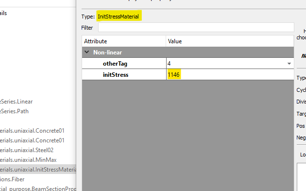

It looks like the initStrain material has an issue with the number of components it gives as output.
Use the initStress instead (using an initial stress equal to your initial strain times the young's modulus):
This has the same result as long as the init strain is less than the yield strain (which is the case in your example)

Thank you very much, it helps a lot
