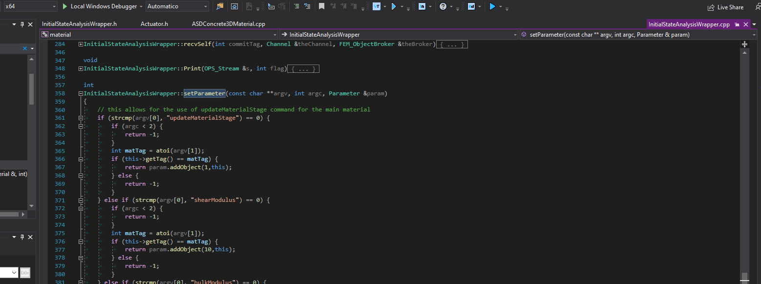

Post by STKO Team » Thu Oct 24, 2024 10:23 am
The InitialStateAnalysisWrapper does not support the "materialState" keyword for parameters!

Post by Lei Lei » Thu Oct 24, 2024 10:49 am
The BoundingCamCly material needs "materialState" to enter the plastic stage.
Is there another method to conduct the initial analysis with BoundingCamCly material?
